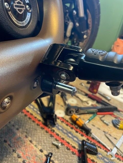

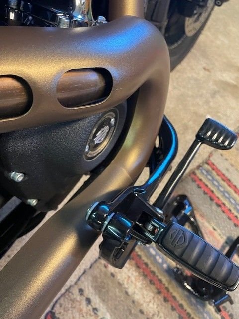

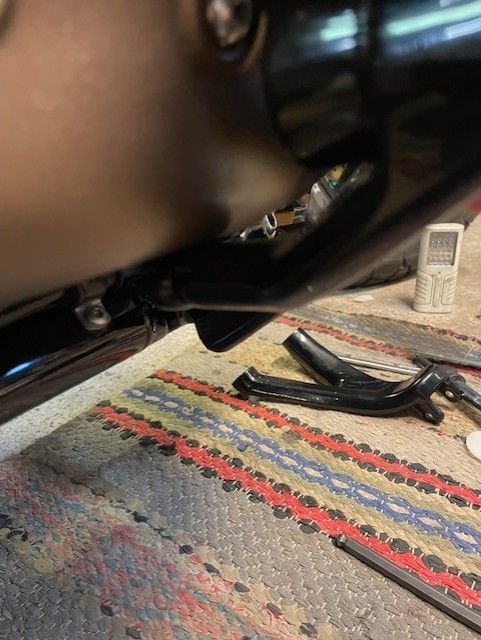

Well, mid contrls arrived and as expected the shift side went smooth but the brake side not so much, has anyone here fitted mids with stock exhaust ? the two pipes above each other is no go for the brake pedal and the bracket it self hits the heat shields, I have sent question to the seller but not so hopefull of a solution from them.
can you make them fit renoving the exhaust heat shields?

Maybe but brakearm will probably hit underside of exhaust anyway, sent pics to seller, going to see what they come up with first.

Well, the problem is solved, putting ths out here if it can help anyone in the future. When I ordered the mid controll set I did not know there were two different brake side models and off course i ordered the wrong one (at least if running stock exhaust) so now I finally got the one needed for the Bob.
If I ever change the exhaust the first one I ordered will go back on, I don´t like the way the brake pedal mounts on top of the peg but for now I´m happy with how the mids feel compared to the stock position.
