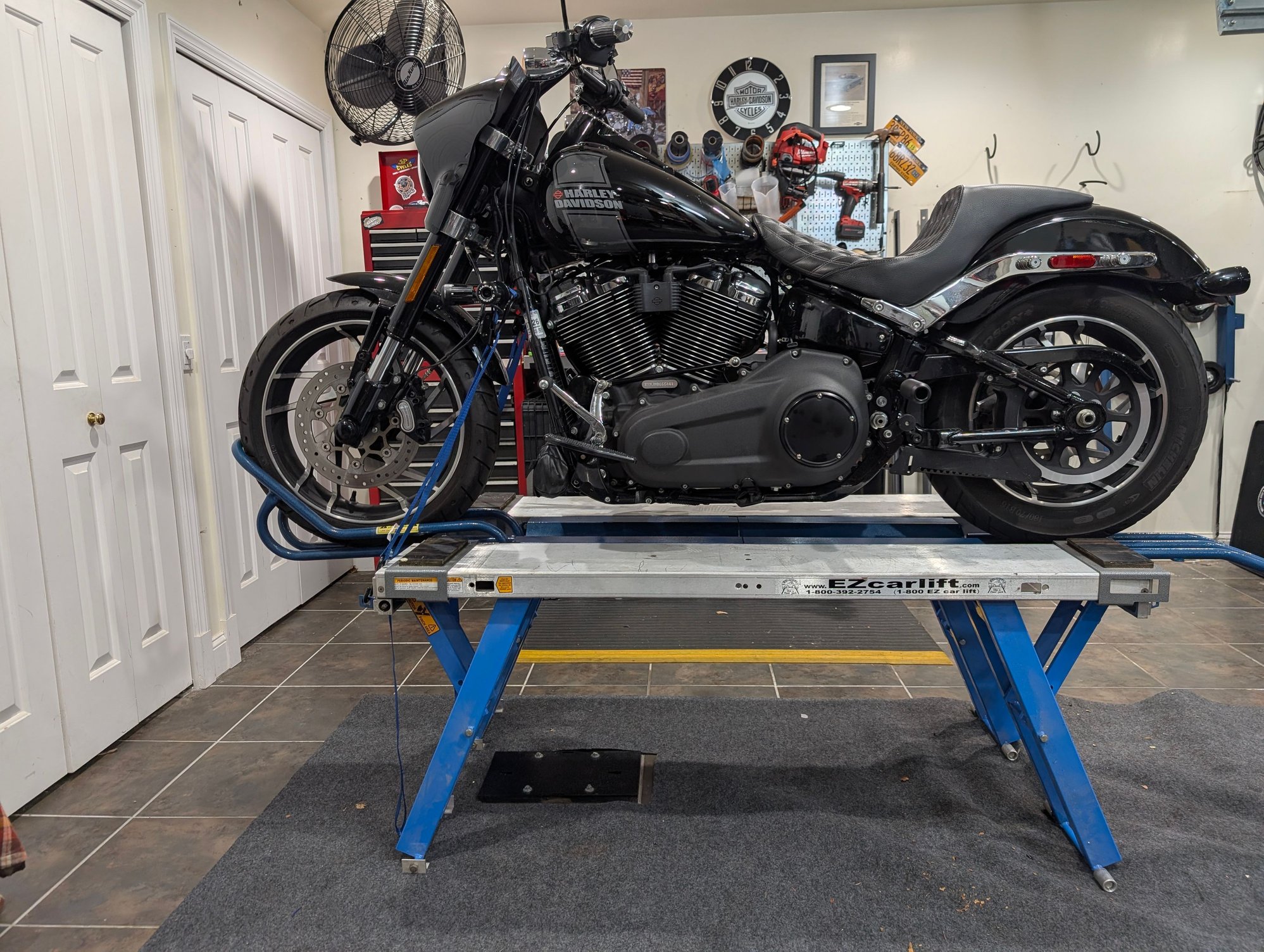

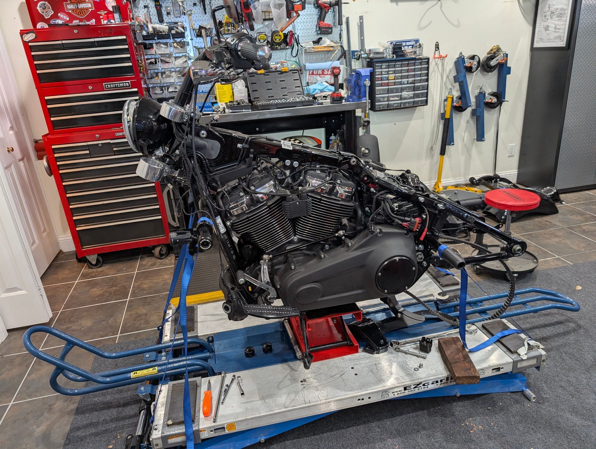

This was my Sunday...
BEFORE
AFTER
New tires came in so I pulled them and I'm planning on powder coating the wheels. While I'm at it I'm gonna do the fender struts and Triple trees so I started to dismantle everything yesterday.

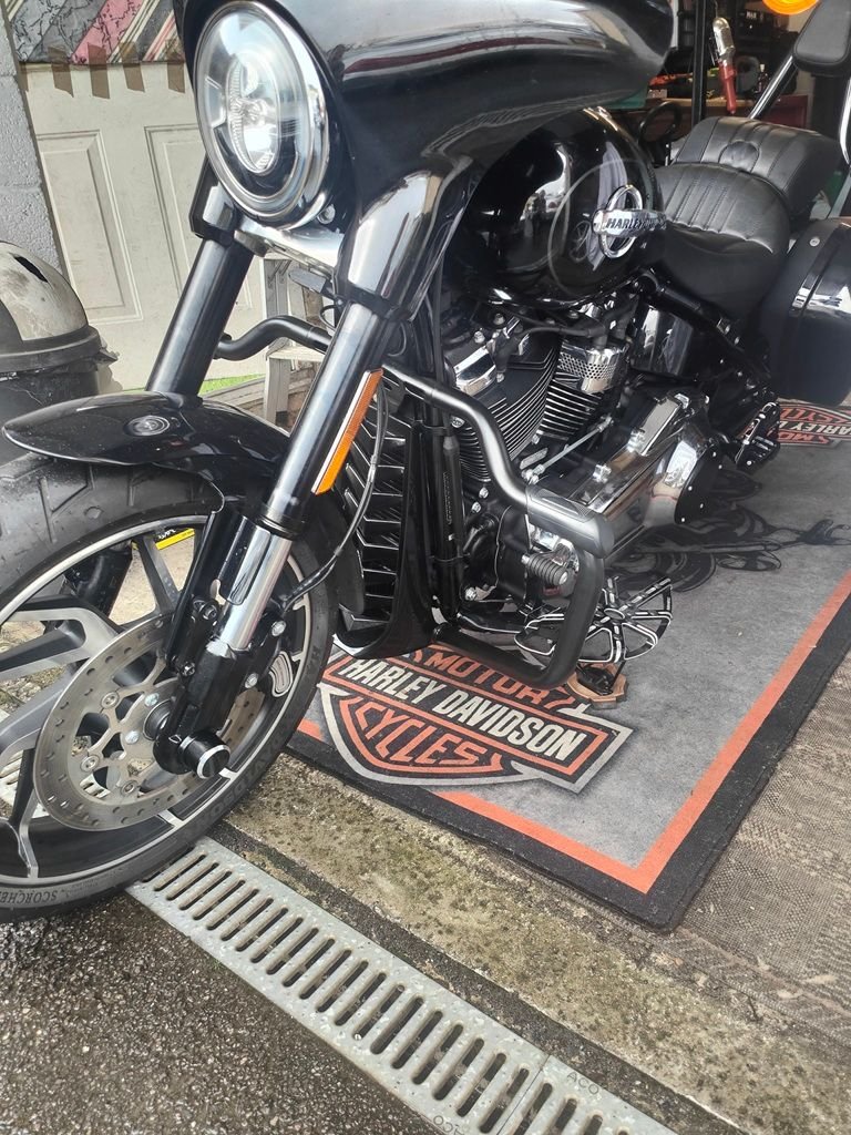

Hooray!
Floorboard conversion done

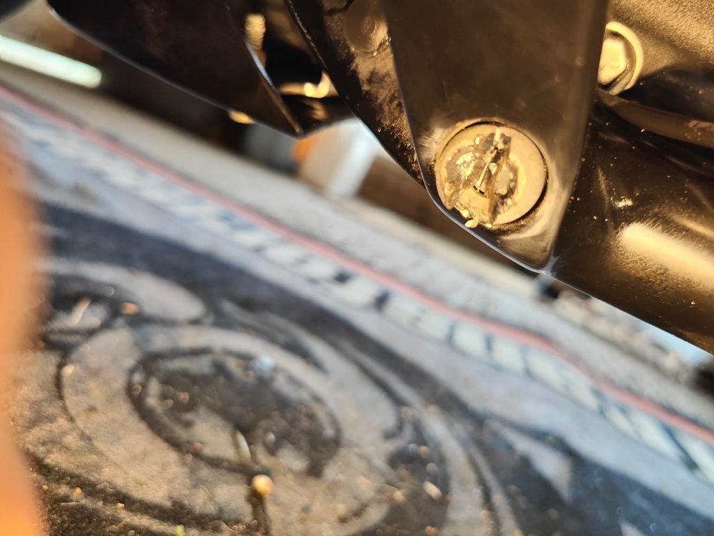

One of the rider peg bracket bolts was an absolute PITA - It basically seized in - way too much Loctite!
Tried all sorts, Impact driver, heat, etc. - to cut a long story short, I ended up removing the head off the bolt so that I could remove the bracket assembly and then used a proper heat gun and stud extractor to remove it.
The offending bolt:

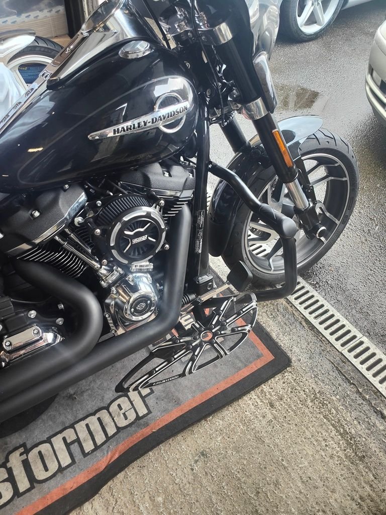

All done
I also fitted a Craftride Moustache Crash Bar (more pics here: Crashbar or flatout bar - Page 2 - Harley Davidson Forums)

That is an interesting guard that you have over your oil cooler, can you tell me who makes it?
Sure...
It's a Craftride Belly Pan/Chin Spoiler
