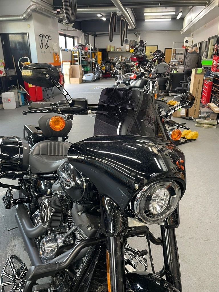

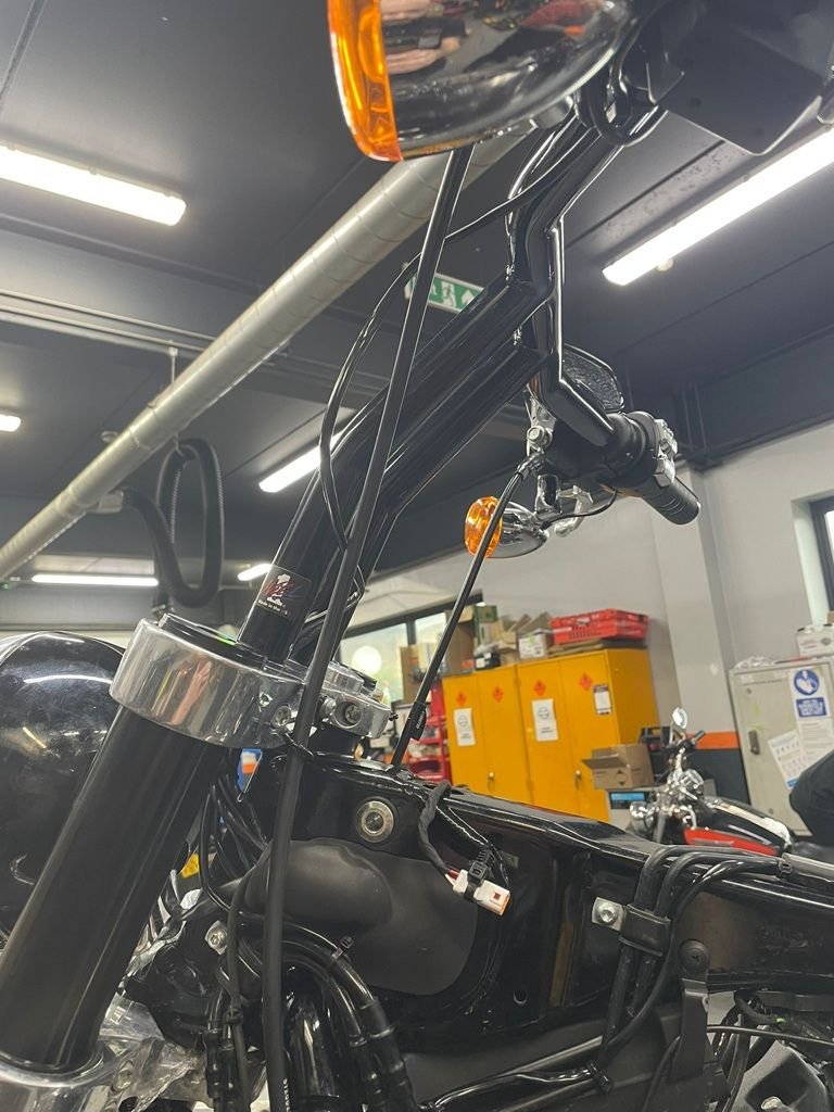

Good news and bad news on the handlebar situation.
Good news is that things are progressing and the Clutch Line looks as if it will be ok (just!)
Bad news is that the brake line is going to have to be extended (or a new brake line) - it's really tight but the worst thing is, the bottom part of the line, by the triple tree, squashes against the upright of the frame - I'll try and upload the videos to show.

All done, a quick wash and then ready for me to collect

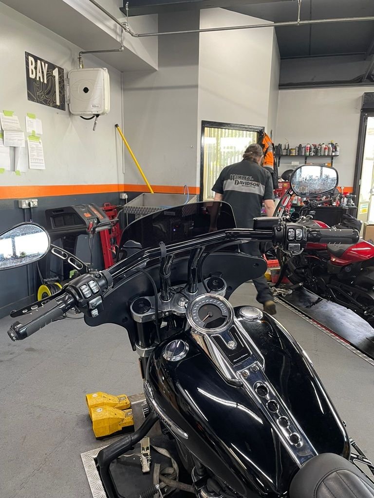

Those bars look great! Very similar to mine, as we've discussed in the past, however, yours are definitely taller than mine with the 2" spacers, hence why you needed the extensions.
Hopefully you dig the riding position too!

I guessed that your setup was the Street Slammer drag bar with 7" integrated risers (+ the bars 1 1/4") with a 2" DK riser extension making them 10 1/4" high (rise) total - which turned out to be right on the money with the 10" rise!
These are the set of Wild 1 CHUBBYŽ 10" Pullback Drag Bar (WO507) in Gloss Black so expected them to be about the same, so was somewhat surprised by needing to extend the brake line.
Anyway, I'll be very interested to see/measure the height when I have the bike back.
I'll report back here with the height measurement and how I feel about the position but from the pictures it's looking good.
