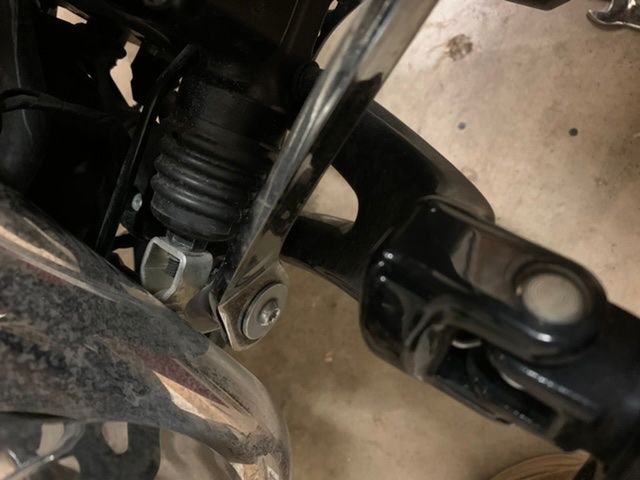

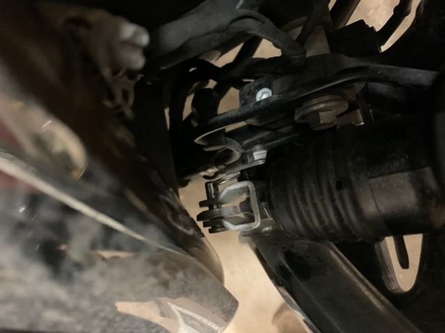

Has anyone done this for a bike with forwards? I put mini boards on my sport glide (forwards are stock) when I replaced the stock foot pegs and I want the brake pedal a tad higher.

Took a look when I got home from work, based on the curvature of the exhaust, I’m not sure I can get the pin out of the clevis anyway. And, I don’t have a wrench with a short enough handle to loosen the lock nut, thanks to the slant of the front exhaust header. Ugh :/

After a lot of curse words, I was finally able to get it to work. I only was able to do 3 full turns of the clevis, otherwise I wasn’t going to have the clearance to get the pin back in (I tried the 5 first), but still better than nothing I suppose.
Looks like with the forward controls you're pretty limited.
yeah, it was mostly the curvature of the exhaust barely giving me clearance to get the pin in that gave me the most trouble. I had mini boards on that I had to put completely flat before to get a little more leverage on the brake lever, but I was able to adjust the brake arm enough to be able to put the mini boards back at a slight incline, which then took pressure off of my hip hinge while sitting. Overall, considering it a success
