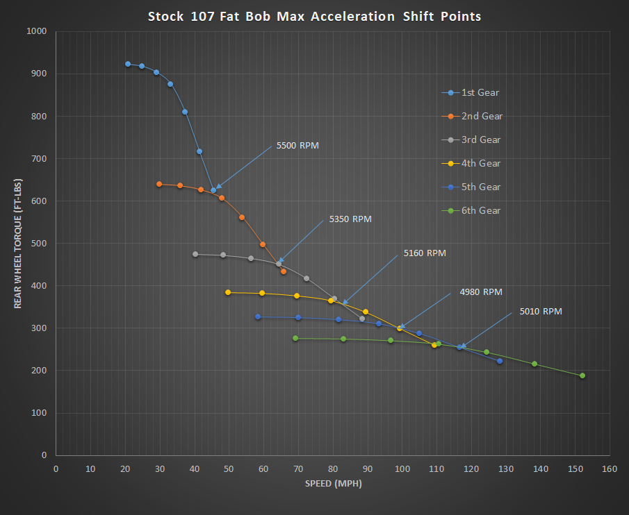

Newbie here ....BE NICE!....... So, with a M8 softail bike,stage 1,for maximum acceleration, more or less shift at what? 4K? T I A.

Here's the power and torque for a stock 107 Fat Bob as measured by Cycle World", followed by the best shift points for maximum acceleration.

Thanx! I shoulda known a helluva lot tighter!
