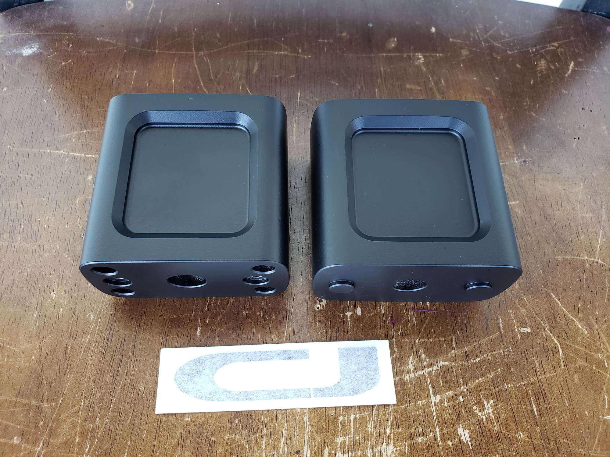

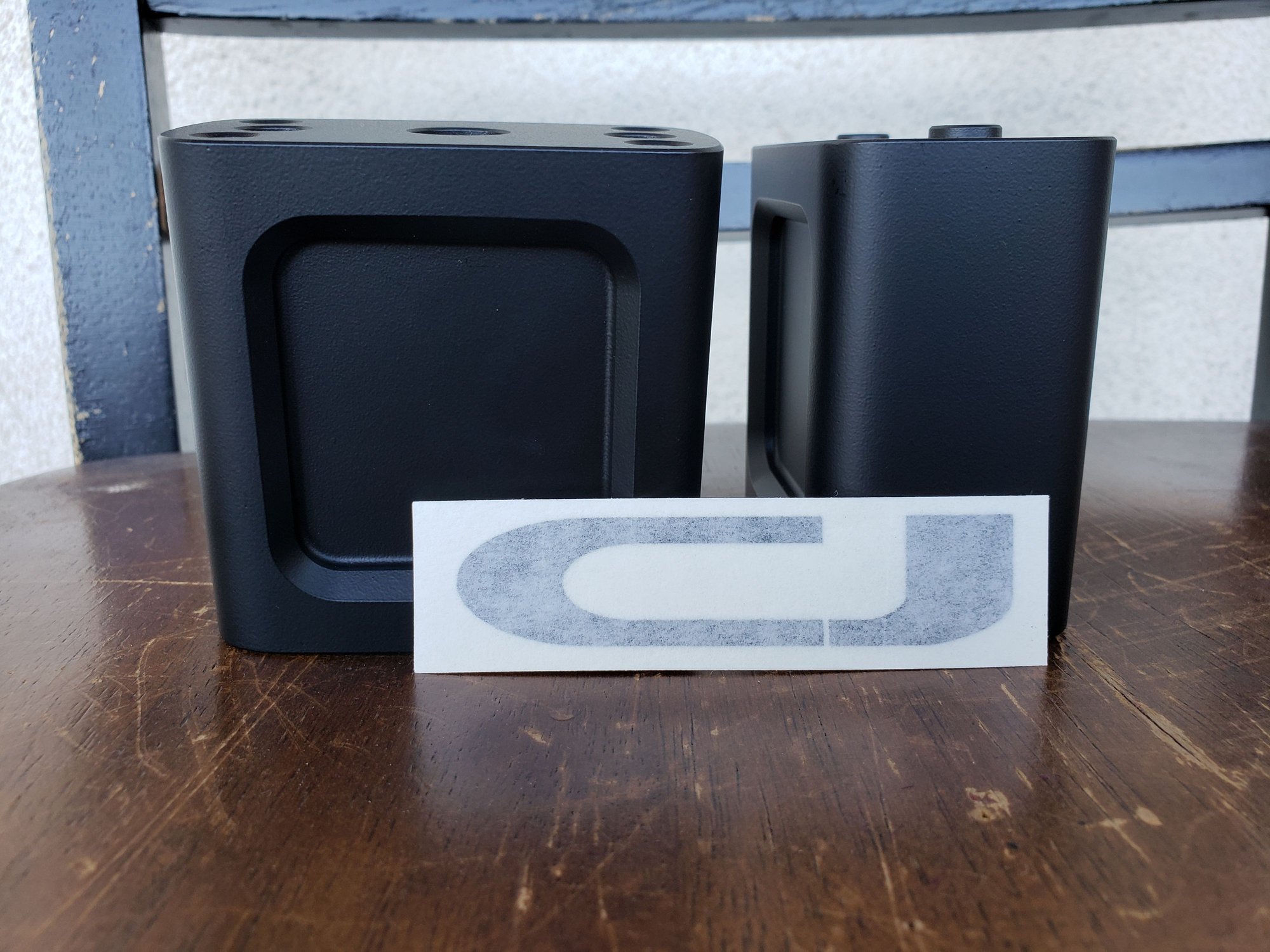

My riser extensions came in today from CJ Motorsports. The quality seems to be top notch and the powder coating looks great. Unfortunately I can't install them until tomorrow evening so the fitment and first ride report will have to wait until tomorrow night or Saturday morning depending on when I'm able to start and how long install takes.
In the meantime here are some pictures of the extensions.

Default Looking Good
NICE! Those extensions look like quality pieces! Anxiously awaiting install and ride report.
