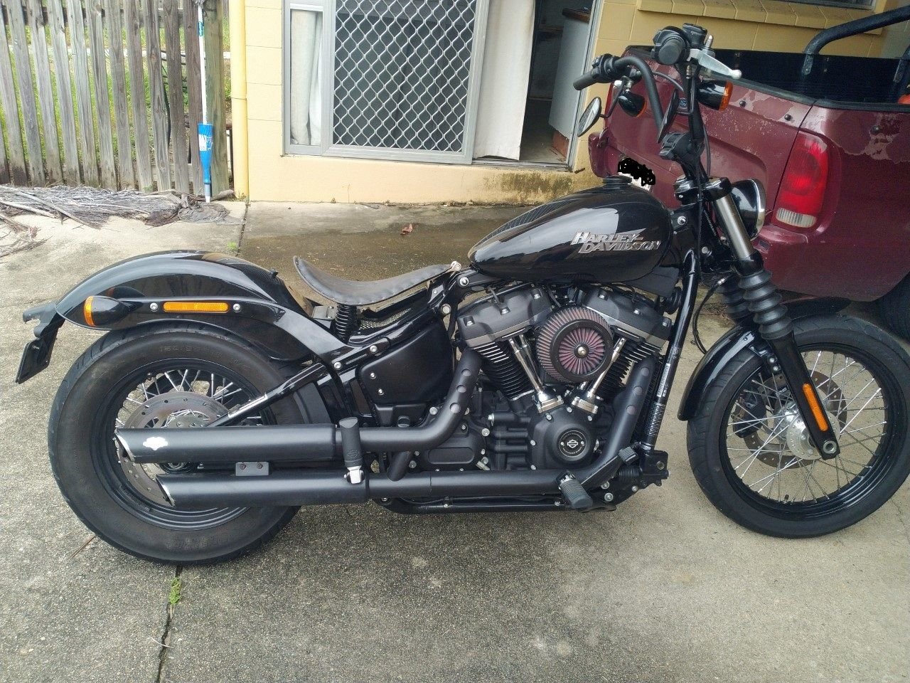

I don't know if this helps at all, but I put the longest stock HD shock in an FXBB(shortest shock) and I still use the stock jiffy stand .It does lay over more but not much , I also lowered the forks in the triple tree to just under level of the top triple clamp at the same time.

I'd love to see a pic of your FXBB if you wouldn't mind. I'm considering the same for mine.

OKey D'oh key
The fender and struts will be coming off and an alloy hugger fender guard will be going on for cools .
The **** is jacked up and it looks weird but I have more clearance .Today I took the forks down through the triples another 3 or 4 mm(3/32 to 1/8") than in this picture.

Awesome looking bike, thanks for the pic! Are those 2 inch risers with the stock bars?

Yup , they are.

Would you mind sharing which risers you have? I have no clue which ones to order, so many out there.

They're from DKCustoms those guys are site sponsors here, they're stand up guys too.
I think they're just the 2" black thin ones , they work that's all that matters.
