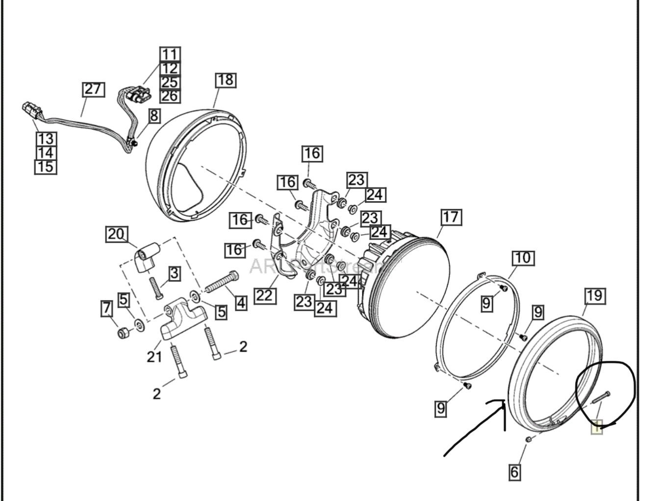

The Road King frenched and visored trim clamp over the existing ring. You are supposed to loosen the bottom screw (circled), slip the trim over it where is fits between the OE trim and the bucket (arrow). You then tighten the new one down which in turn clamps itself and the OE trim down.
I have a black visor trim and a pair of aux lamp trims I had powdered black as for some reason HD doesn't make the aux light trim in black, only chrome. Anyway, if anyone is local to me and wants to try fitting them, you're welcome to come by and try. I'm just north of NYC.
