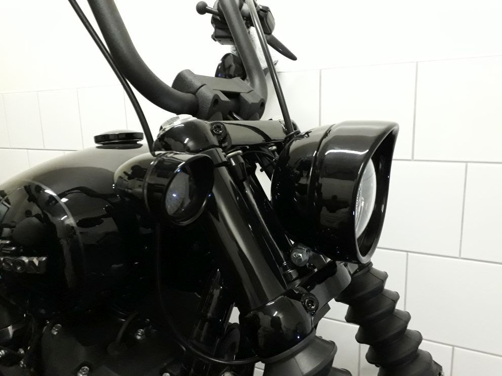

I had the same issue with my FXBB,
I ordered a aftermarket and completly trimmed and altered it so now it fits like a glove and after I painted it with gloss black paint it looks killer, to me at least . The setup from the
new headlights is different then in the past, the glass wont comes out like before but is bolted on the triple tree and the metal part sits loose around it and kept in place with the ring.

It was to big in diameter since it supposed to be placed on top of the oem ring but that did not work. So I removed the oem ring and trimmed the visorring in diameter (no more gap were it comes together ) and then I bought a big
O-ring and that sits between the glass and the vissor ring. It all looks like oem even from close by.

So looks like shaving the gap is the key to make it fit. Beside closing this gap and oring was this it? I understand this is OEM ring for pre M8 era correct?
