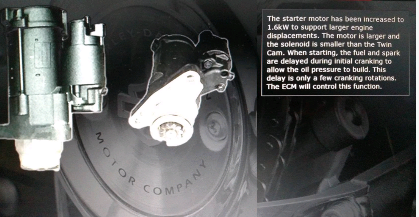

Isn't it an option on the TTS tuner, Cranking Spark Delay. Maybe Harley incorporated a 1 or 2 revolution delay on the M8's.
the spark plug wire swap is an interesting result

Originally Posted by HotRod917
Isn't it an option on the TTS tuner, Cranking Spark Delay. Maybe Harley incorporated a 1 or 2 revolution delay on the M8's. The spark plug wire swap is an interesting result
Just saw this today, from H-D Technical Forum:
