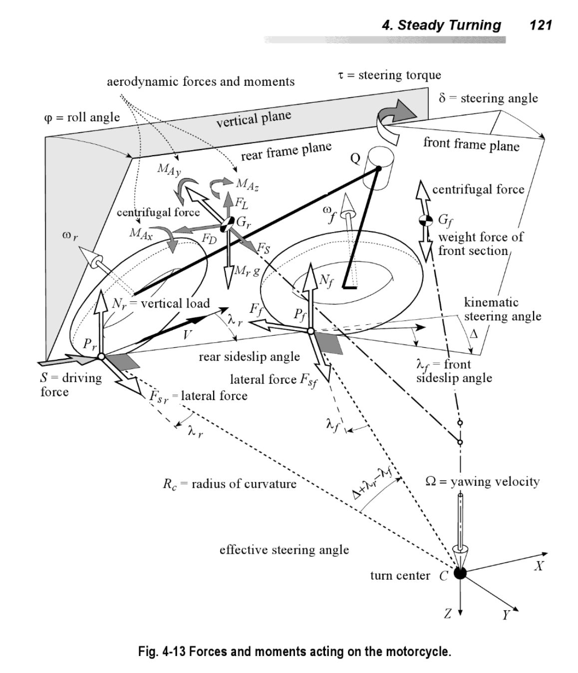

The comment about stability may be related to "duck walking" the bike around in a parking lot where a lower seat height can give confidence to the rider. The physics of motorcycle dynamics dictate that a lower CG is less stable (see "Motorcycle Dynamics" by Vittore Cossalter). This is a complicated subject for sure.
This is accurate. IMHO lowering any bike ruins the handling and has more adverse effect than it does positive. It's best to find a bike that fits you correctly and leave the suspension at stock height.
