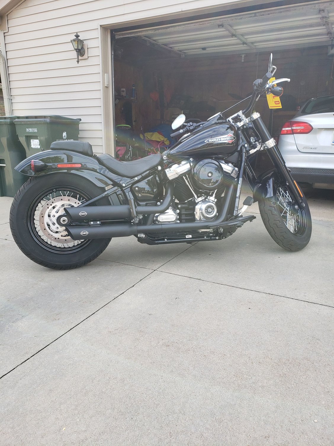

I picked up a 18 Slim today, it feels good to be back on 2 wheels again!

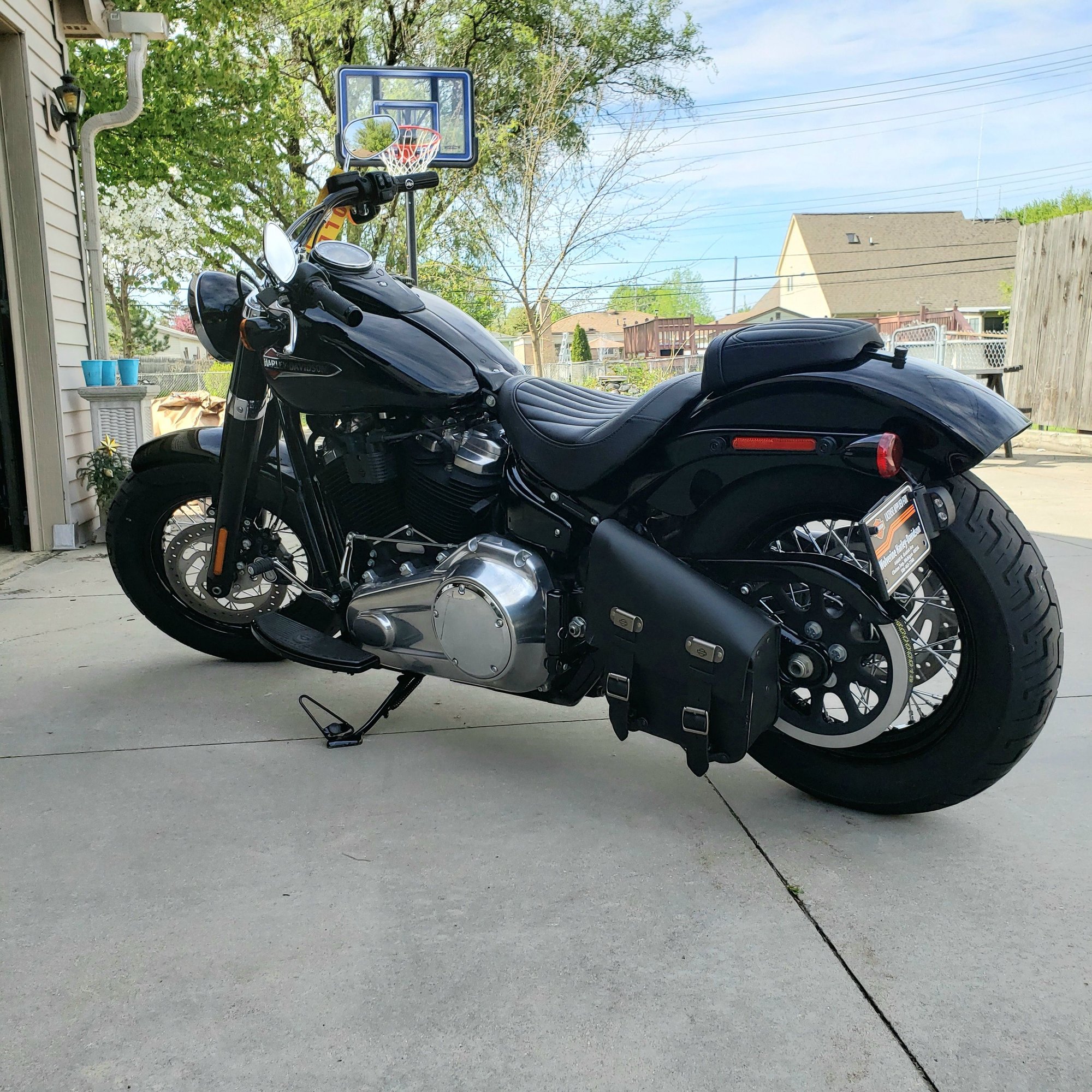

Few small mods lately...slip-ons, smoke turn signal covers up front, swing arm bag, derby cover

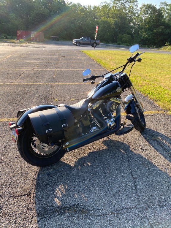

Just picked up mine a couple weeks ago. I am in love.. In the process of moving the turn signals down to the forks for a cleaner look
