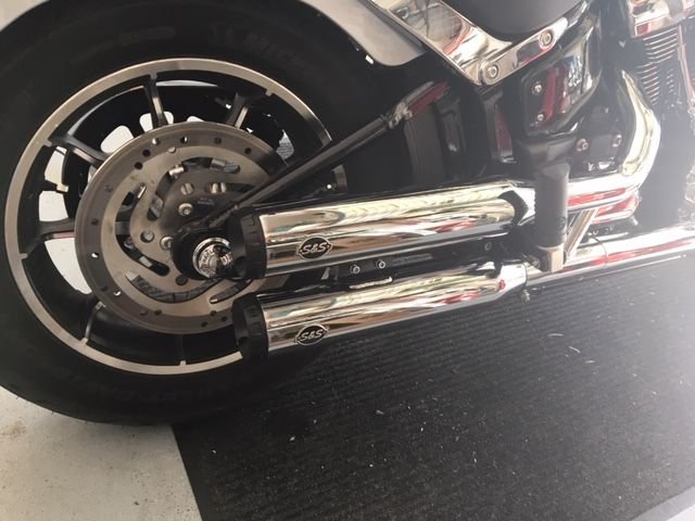

3. I used the HD SE Stage 1 high flow air cleaner and SE Street Tuner. But, the HD SE slip on mufflers sound is disappointing. Several after market slip on mufflers are CA compliant and will not void your warranty. I used the S&S slip on mufflers (see photo) and like the functionality (easier access to check rear tire pressure and brake pads) of the shorter length and sound, but this is not your only after market option to retain warranty and CA compliance. Suggest you check with other owners who used various slip ons and listen to their bikes before making a final decision.
Good luck. Stage 1 Upgrade is worth the money and effort.
S&S Slip On CA compliant high flow slip on muffler.
