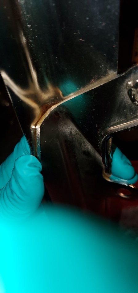

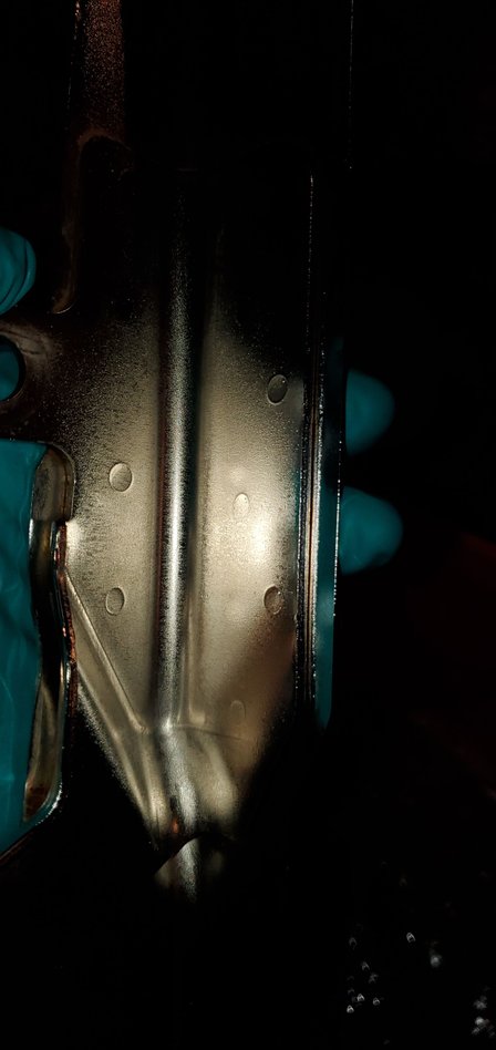

AnyoneRAnyone else ever see rust drops on their swingarm?
2018 Fatboy.
I think I found the problem.... Looks like the belt guard.

I posted on Facebook also and had a member advise there are a couple holes in the swingarm with plastic caps. I will be checking my bike if I remember in the morning. this is where this member advised the "rust" drops were coming from.

It is definitely coming from the plastic plugs, the freaking swing arm is filled with water and their is no drain hole at the low end!

HD didn’t treat or paint the threads under the plastic caps in the swing arm. I pulled mine for pegs and was rusted awful. Had to brush out and throw some grease on and then recap.
