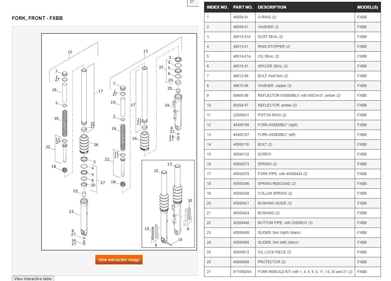

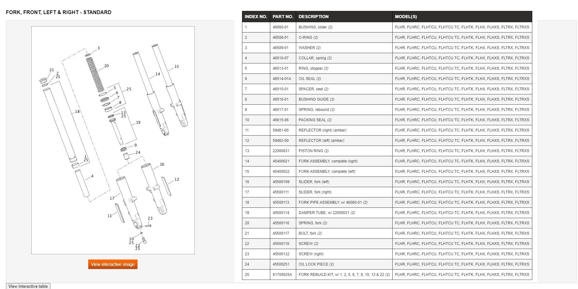

Does anyone know what differences there are between the 49mm forks on the Touring platform and the 49mm forks on our softails?
I've come across a set of take-offs from a Ultra Limited and wondering if this would be a good way to go about a dual disc conversion.
My bike is an FXBB so my wheel already has provision for a second rotor, just need to get another caliper on there somehow.
Also fender mounts are different, that isn't a concern, I'm also going to a 21" rim so I need to change the fender anyway.
Mainly just want to know if there's any reason why it won't work or if these would be a downgrade handling wise or any other issues I may run into?
I have full parts diagrams below but they don't have dimensions, are the touring forks shorter/longer etc?
FLHTK Fork parts diagram
FXBB Fork parts diagram
