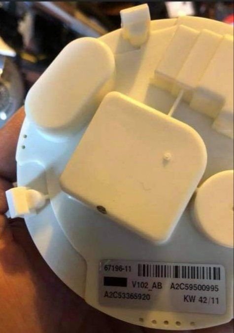

In one of the several other gauge condensation threads I pulled a picture of somebody that has a solution to drill vent holes in the gauge.
The idea of dropping the bike off to fix this and then it reappears doesn't appeal to me.
oldmike ! Have you tried this mod yet ?

From what my dealer told me, the issue is the gauges aren't sealed up at all. If you look on the back side where the wire plugs in, there's a gap all around where that plug goes. Thereby letting moisture and humidity get in easily, but not out easily. The only solution is aftermarket. I posted in the what did you do to your Softail thread. I prefer the asthetics of the OEM gauge, but am much happier that I can actually see everything I need to now, plus a bit more. I swapped mine to the Dakota Digital MLX-3012 gauge and couldn't be happier.
