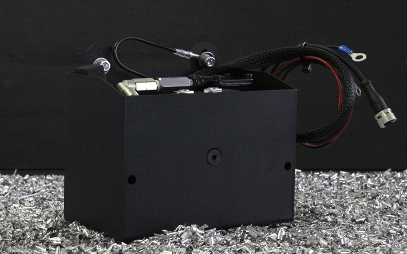

I was lost the name of the brand and website but just found it back.... this was the one I liked, the compressor is more or less hidden in a black box.
Platinum Air Suspension
The only thing that "worries" me is that as the header on their website speaks of "Softail 2018 to 2020" and then under the photo's they say ,
