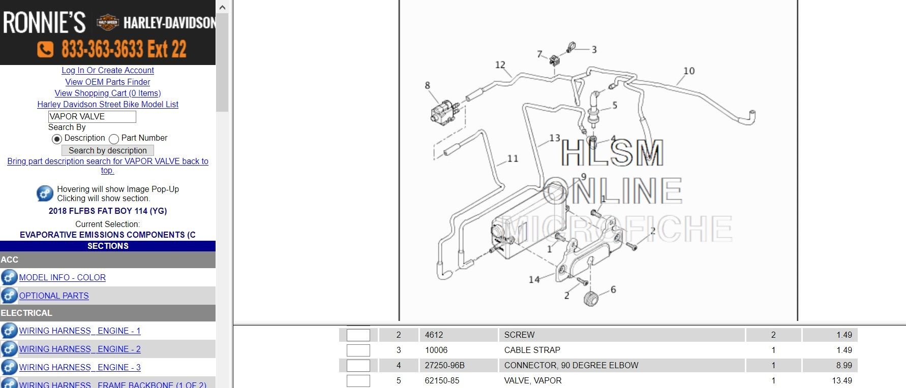

Part Number 5 in the middle of the diagram
thank you

You're welcome. Sorry I couldn't post a picture of it on the bike for you.
