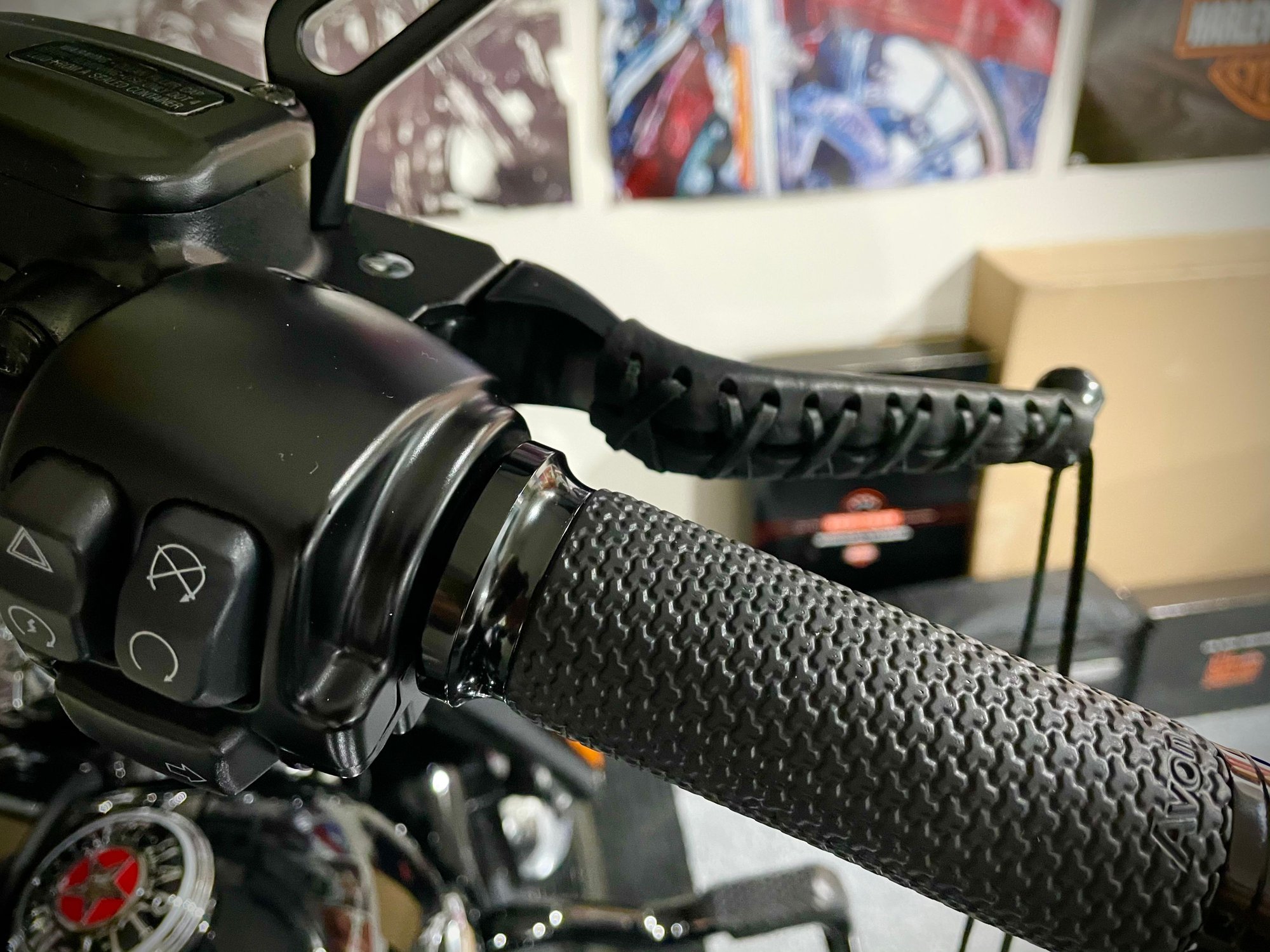

Yup I filed these pliers tips to fit. It was fairly easy job after that my levers and awesome leather covers from etsy are on. Love the look of this set up. Thank you guys for your input.
