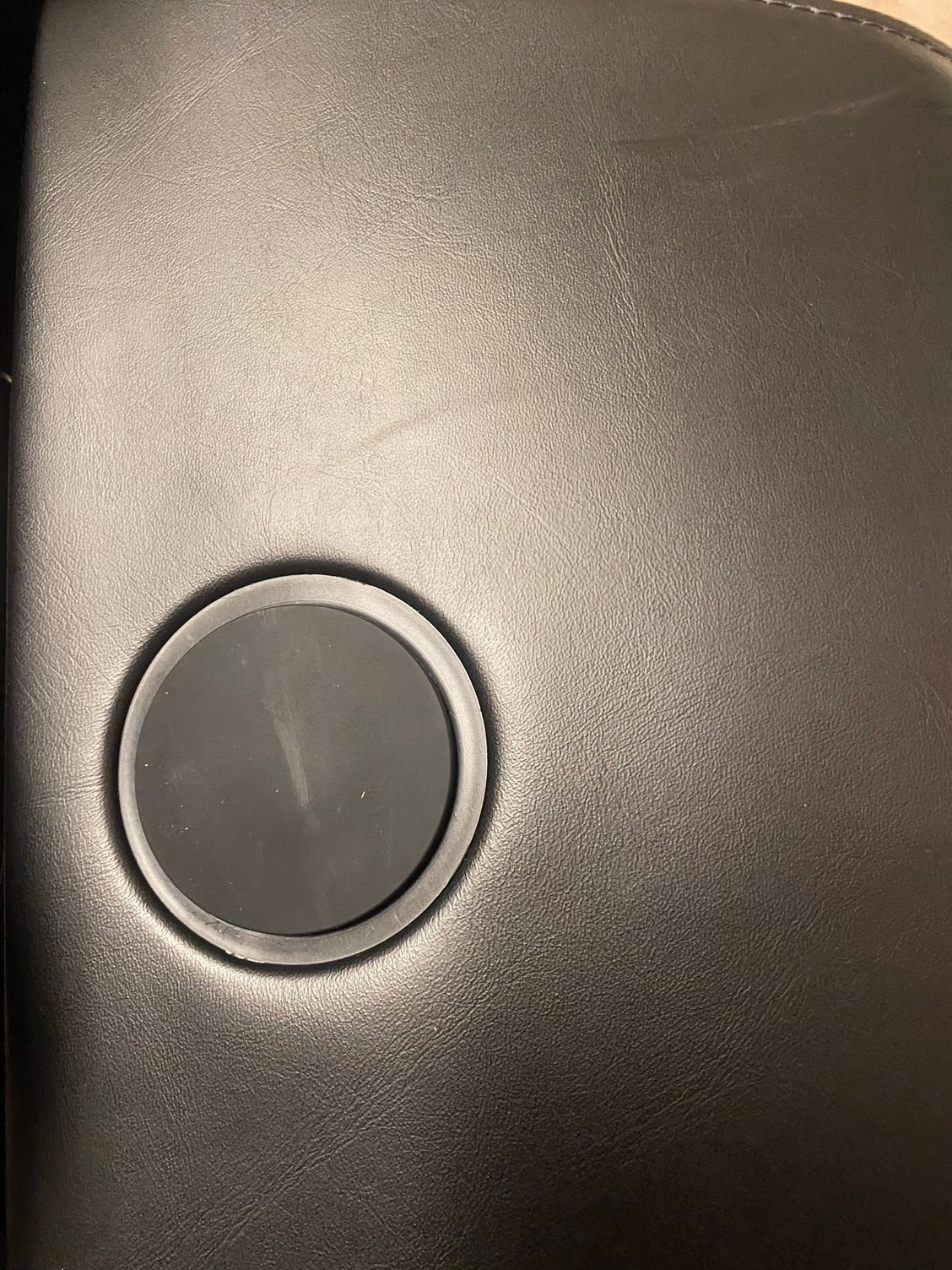

Trying these silicone pipe caps to stop water getting into the bags they are soft so are a tight push fit to cover the lock , where I suspect the water gets in

Do you have a link to purchase, Marty? They look great!

It was an eBay search, I have been trying to find a solution, as the panniers after a a wet few days touring in Wales leaked, especially when the bike was parked up the lock area fills with water and I think ingresses through it.
I hope this will stop the problem, seems to have worked when washing the bike.

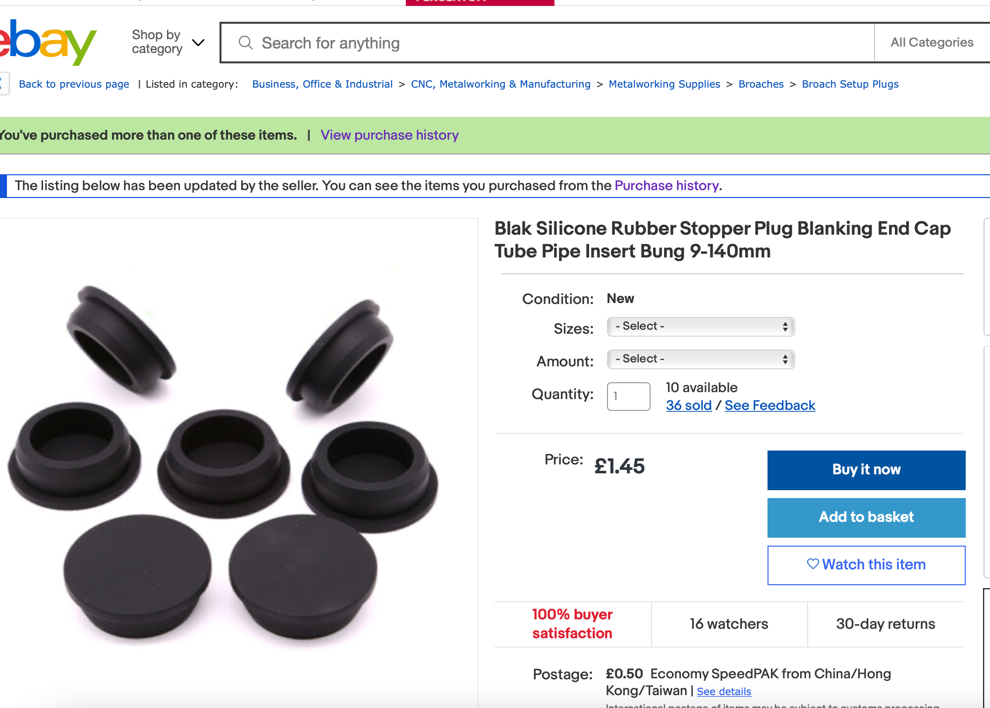

If you look at the screen shot search for the result, you have to choose your size, the size that is a good snug fit is 56.3mm, it won't fall out on the go either, also bought a different size for the wife's Sportster panniers as well.

I'm going to try these, I found them on the US site https://www.ebay.com/itm/Blak-Silico...oAAOSwmjZdsrcx
