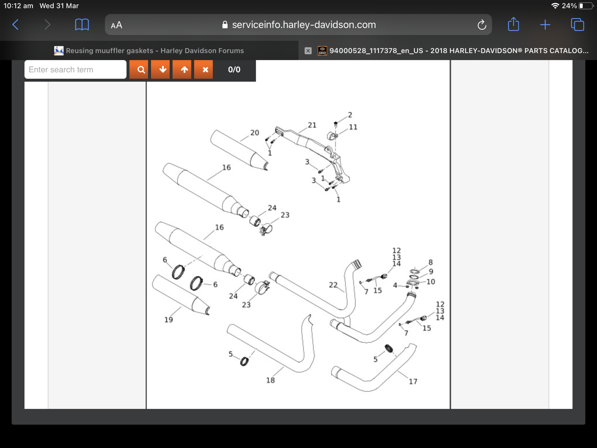

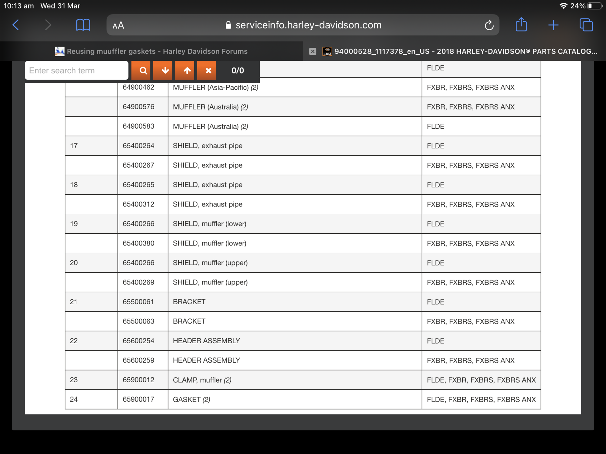

Thought the mufflers just slip'd and clamped on to the head pipes? Is this a softail/year specific thing? Only gaskets I have ever seen are for the head pipes and cross-over pipe.
Not always obvious, but see part #24 in the following extract from the parts catalog:
