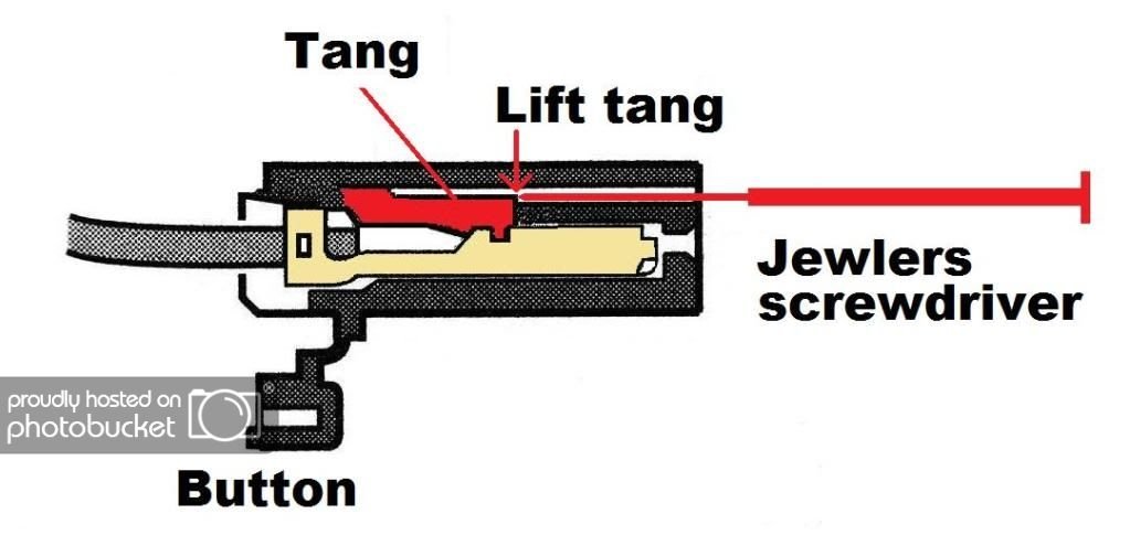

Yes, I did this a couple of times.
I lift the front of the tank to get to the junction block under the rubber boot. Unplug the two turn signal plugs. There is a small trap door on top of the plug I lift and work the wires through, and pull back the rubber gasket, save the little white dummy pin. Some people just cut the hinge on the trap door to make it easier.
I use a small safety pin (not jewelers screwdriver) to unlatch the tang while using a bit of tension on the wire to feel when it is free. Be gentle with the pin, you'll feel when you have ahold of the tang you need to lift. Take pictures to keep track of pin location in the plugs. This diagram helped me the most to understand the working of the plug and pins:
