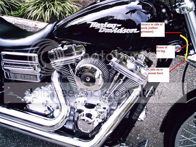

Not a great picture of teh signal wiring, but hopefully will give you an idea.

Hey guys, there is a small hole at the bottom of the neck in the fork. You can route the turn signal wires out that hole, zip tie it them as they cross at the brake line retainer under the tree, then run them straight out to the light. It is a lot cleaner, and you wont see them coming out the side of the frame.
