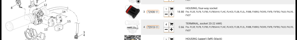

Just a FYI, The connector Harley uses for hand controls and indicators on it's newer bikes is the JAE MX1900 type
on the rear of this plug the sockets are numbered and will match the terminal numbers in HD's wiring diagrams.
In the UK, rather than paying Harley 18.00 odd quid for one
You can buy them from RS Components for Ł6.10 for a pack of 5, plus postage. Male and female pins and sockets are also available from RS, along with most of the other connectors you'll come across on your bike.
​​​​​​https://uk.rs-online.com/web/p/autom...ctors/6633621/
