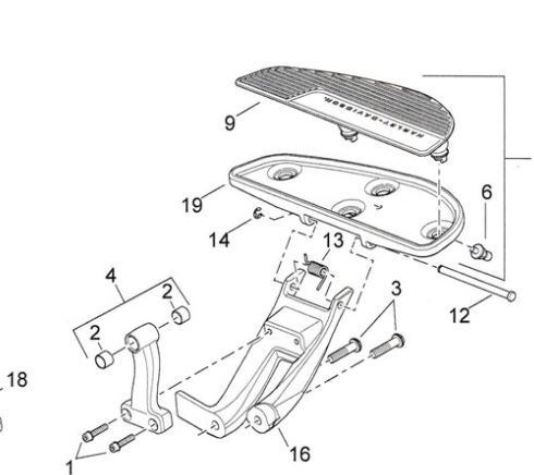

Here’s the part for 2018 Heritage Softail

As others have noted, the longer, splined shifter shaft is part of the kit.

Originally Posted by Nomadmax
I can't speak for the m8 but on a twin cam you're gonna have to pull the outer and inner primary to install that shaft.
You do NOT need to remove anything but the stock shifter to swap the shaft.
I found that you could remove the standard shaft but could not fit the longer replacement shaft without removing the floor board mount which has the gear shaft bracket fitted to it, there's just not enough room!
The foot board is only two torx screws!
