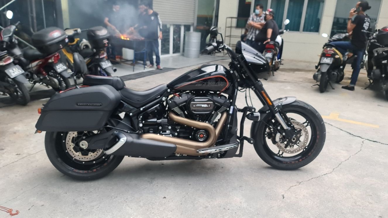

First apologize if my English not that good as this not my mother tongue, I had a customized FXDR, even though already had a awesome lean angle, its not enough for my riding style, so I did bung king extension to increase the rear height, however it seems the 12.6' shocks really have a short travel and very harsh when dealing with potholes on the road.
I've been eyeing some shocks like Progressive 946 and uber Ohlins HD506, however their length only up to 13' then the RSD came into the picture with the RSD Fox 13.5'.
Have anyone change their shocks with FOX RSD for their Softail?

The FXDR designed to have the highest lean angle amongst the Softail family, however since I mod it and change the front control to a floor board, that lean angle reduced and easier to scrape, good thing about floorboard is I can reposition my foot in different stances, and gives flexibility during riding ..
And it came with the 12.6' shocks (not even full 13' like Fatbob), what I did, changed the end of OE shocks mount with bung king extension (add around 1.5' height with load) and voila it returned the missing lean angle that was there before.. now reason why I want to change to FOX, due to the OE 12.6' shocks does not give much travel/rebound and quite jarring when hit some potholes/bumps on the road but still like to maintain the same ride height as the OE shocks + Bung King extension..
Modded form, look at that gap..
