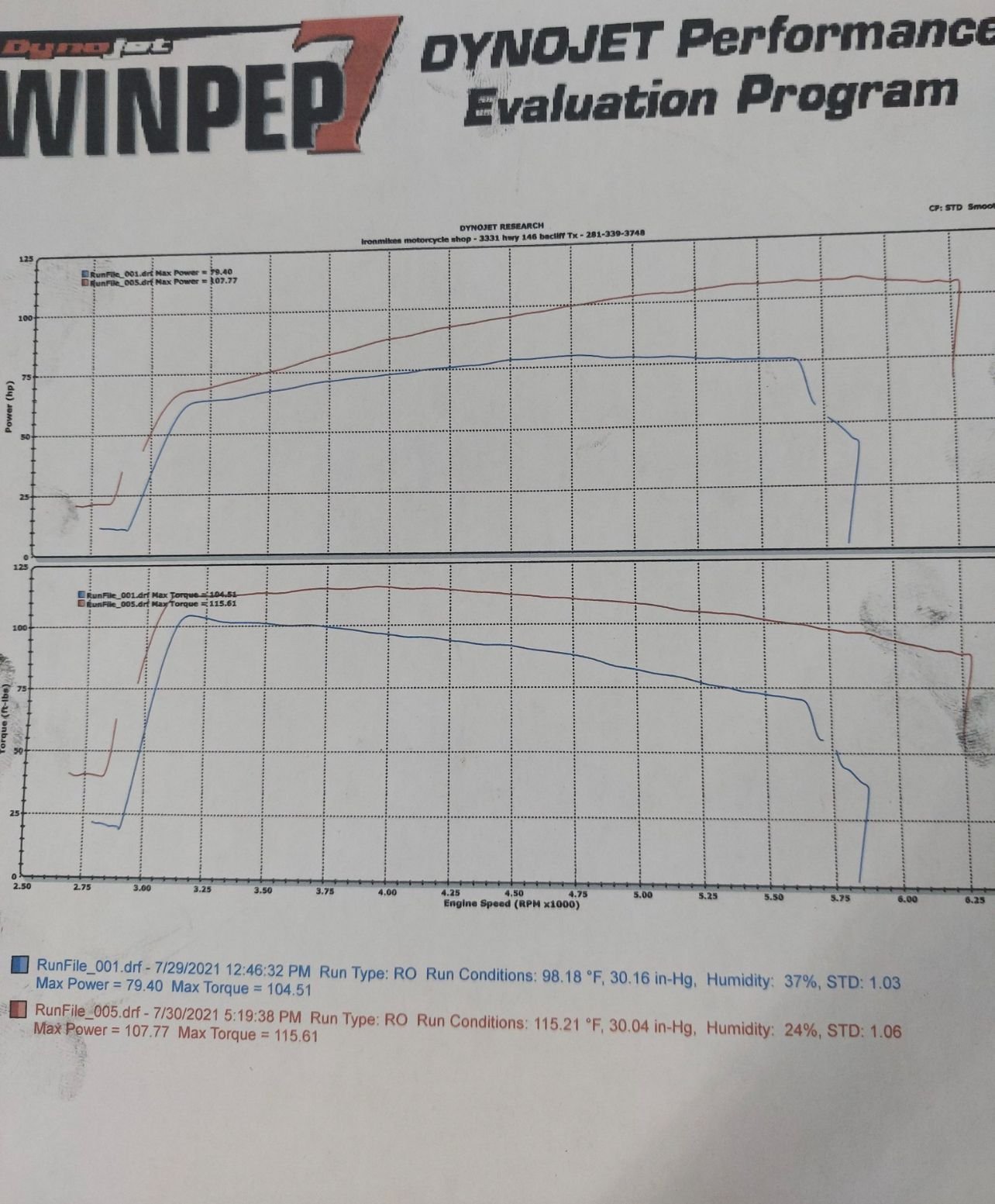

Stage 2 on a 115degree hot *** day with shorty 2-2 custom Ground Pounder exhaust and Andrews 462 cam 107/115. Baseline numbers ran 79/104. With cooler weather I’m sure she’ll make 110/120 easy. 28hp jump, not bad for just a cam abs tune, bike sounds incredible.

Well the 24HP/28TQ at 2750 looks pretty sad.

I’ll find out tomorrow when I pick it up!! 😂

She runs like a scalded dog!!

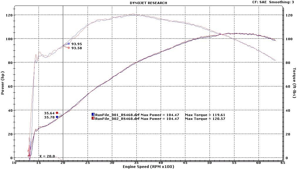

You gained 28 hp and 11 ft/lb of tq, so yeah, it surely feels better than what you had. It is also making a ton of noise now, so that adds to it. But you left probably 10 to 15 hp and 10 to 15 ft/lbs tq on the table because of those pipes. And you've killed the power below 3K rpm. Yeah they look cool and you probably really like the sound, so if that is what you're after you're good, but a good set of pipes will make it run much better. I've got a 107" that made 120 ft/lbs tq and 104 hp. with cam, mufflers, and air cleaner.

plenty of torque and I ride in the 2800-3500 rpm range and that’s where it feels good. Runs great for what I want. Didn’t want to look like all other FB’s with 2-1 that all look the same. That’s not called noise it’s called music to my ears!! Lol On a cool day I’ll get 110/120 numbers. For now it’s good.
