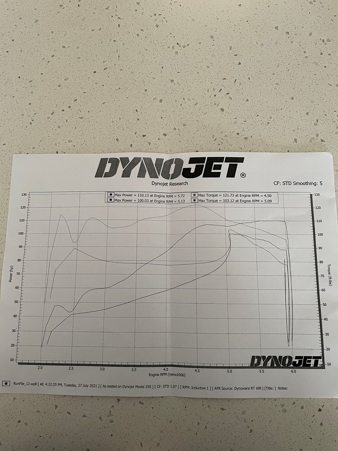

Hey all, I just had my low rider s tuned up during its first service and here are the results. I’m running a two brothers shorty turnout pipe and a s&s 475 cam with the stock air intake fitted with a k&n filter. Just wondering if these numbers are typically what’s expected. It was tuned at the dealer using a technoresearch tuning key.
Any ideas what’s causing the dip on torque? I’m guessing the pipe from what I’ve read.

Yea it'll be the dump pipe mate , maybe baffle it or grab one of those TTI things. Is the air/fuel ratio part of the graph available ? That'd tell the story.

Unfortunately the graph was all I got, I might check with the dealer and see if they can give my the ratio’s

The ECU will improve it over time but will never completely eliminate that dip, looks like it might rev up top fairly well though.

I'm by no means an expert but that's one of the weirdest dyno charts I've ever seen...those lines are crazy. Lol. But I agree...your dip is from the pipe.

Tbrs are known to be one of the worst if not the worst performing 2-1 for the m8 softails. Definitely causing the dip in torque that large. Don’t sweat it too much as pretty much every short 2-1 you find will cause something similar.
fuel moto has tested all of them and says there is no short 2-1 out there that doesn’t have the torque dip at the beginning, some are just larger than others

Agreed, it's a Softail/exhaust thing.
If it's fun to ride don't worry about it.

The dip is normal on softails due to there short exhaust systems in comparison to the long exhaust systems on baggers. The weight savings of the softails you wont feel the dip. I have a 128 build in my Breakout and i dont feel it and nobody has beaten me on a bagger since its installation.

Thanks for all the reply’s , yup I’m not going to worry about it, it’s a fun ride and in 2 years after the warranty period I might change it up and see how it goes.
