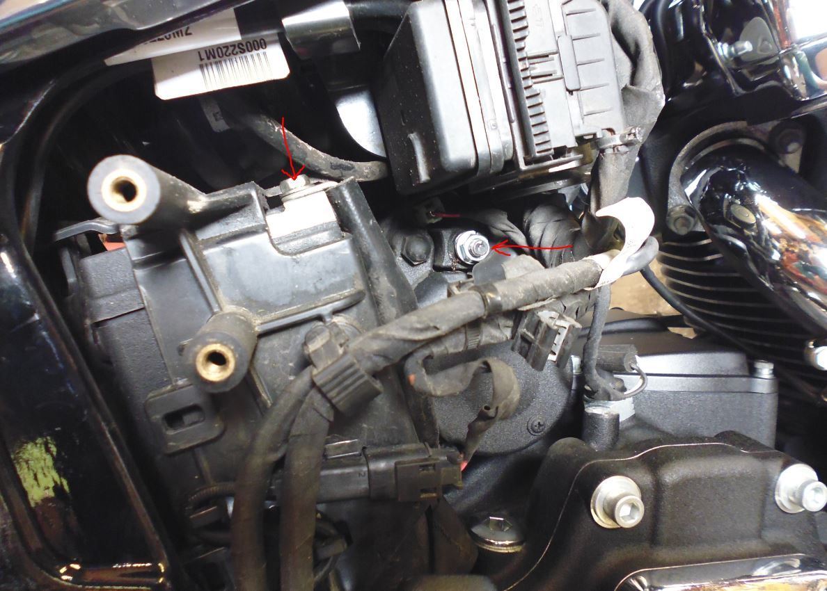

Anyone jumpstart there M8 without removing battery. Cause it’s a ***** fu”” er to remove it. For future reference going n long trip. Ty.

You don’t have to remove battery to jump start:
- connect the red + to the starter power lug, the connect the black - to the ground atvtransmission
(OR)
- just connect to the battery posts
But, once your battery has died, it’s best to figure out why, resolve that issue, then replace the battery.

I don't think there is any easy way to jump the battery in an M8. You don't have to take the battery out but you do have to remove that top battery cover which means disconnecting the negative terminal, removing the cover, reconnecting the negative terminal, cramming the positive jump connector past the monoshock and trying to attach it to the positive terminal. As you said, huge pain in the sack. And if you successfully jump the bike, you have to leave the top battery cover off.
I bought a NOCO GB40 and the battery attachment. I think it's better to just bite the bullet and buy something similar. This way you can go on your trip and take battery jumper with you. If **** happens, then you just have to remove the seat and connect it to the battery attachment.

On the Heritage models it's easy to get a jumper cable on the hot post of the starter motor, as pointed out by TriGeezer above. I don't know about your LR, might be worth adding an extension bar and insulating it until the day you need it. Of course it's easy to find a good ground on any of them.
Over the years I've found that once these small batteries have gotten flattened to where they need a boost, it's time to start shopping for a new one.

It's not that hard to get to the battery for a Boost start on an M8 Softail, remove the side panel connect to the battery negative post and the positive on the starter motor stud, which is under a rubber boot!
