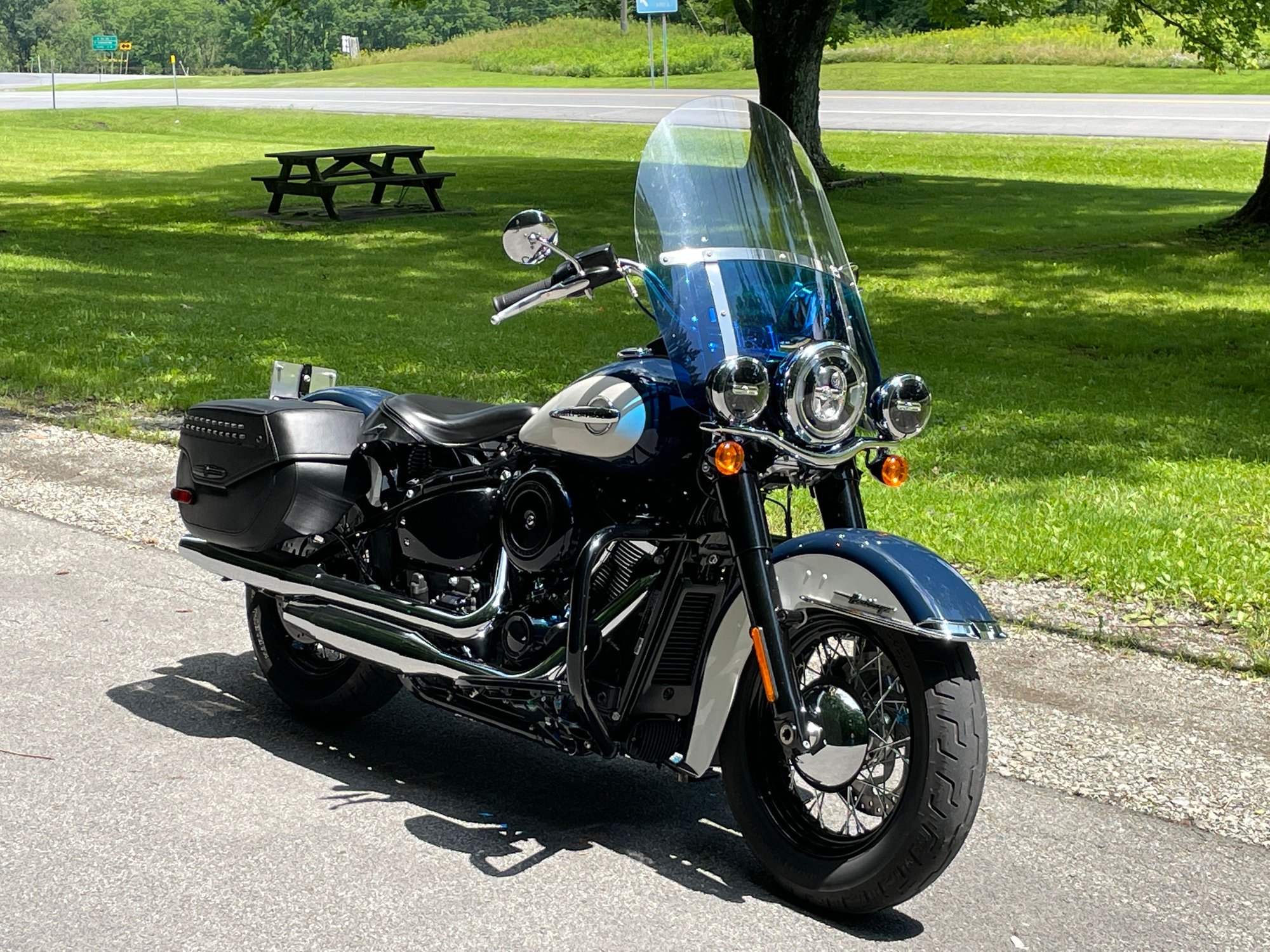

Any taller riders have a 21" or 23" windshield on the Heritage? Would really like to see some pics before I pull the trigger on one.

Here’s a couple of pictures of a 21” Memphis Shades replacement windshield in my ‘19 Heritage. The higher riding position of the sprung saddle necessitated a taller windshield.
If you go this route you will need to replace the horizontal windshield braces with the parts from a ‘17 or earlier Heritage for the Memphis Shades replacement shield to fit.
