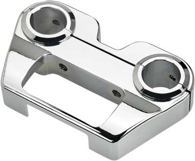

Originally Posted by Lew Carrum
Can different bars and risers be fitted to the standard/street bob range due to the lcd display?
They can, lots of choice if you look around,
https://deadbeatcustoms.com/forbidde...022.1634547155
or different gauge mounts if you want to run T bars,
https://deadbeatcustoms.com/biltwell...022.1634547155
but depending how high / wide you go, you will need wire extensions for the lcd as well as the usual handle bar controls / throttle wire / clutch cable / brake line extensions.
Going by the look of those, just a riser with the same bolt pattern could work and use the Harley top clamp which houses the gauges?
Well yes, assuming that, but as they say, "Assumption is the mother of all **** ups".
You'll only be guaranteed a fit by buying both together.
As Chunker says above you could use HD parts, the Breakout has the same digital set up, chrome 4" riser, or in the HD P&A catalogue there are these in 1 or 1 1/4" pattern,
https://www.harley-davidson.com/us/e...Kit/p/55900227
https://www.harley-davidson.com/us/e...ser/p/55800852
Breakout riser in black
​​​​​​https://www.harley-davidson.com/us/e...it/p/55900157B
