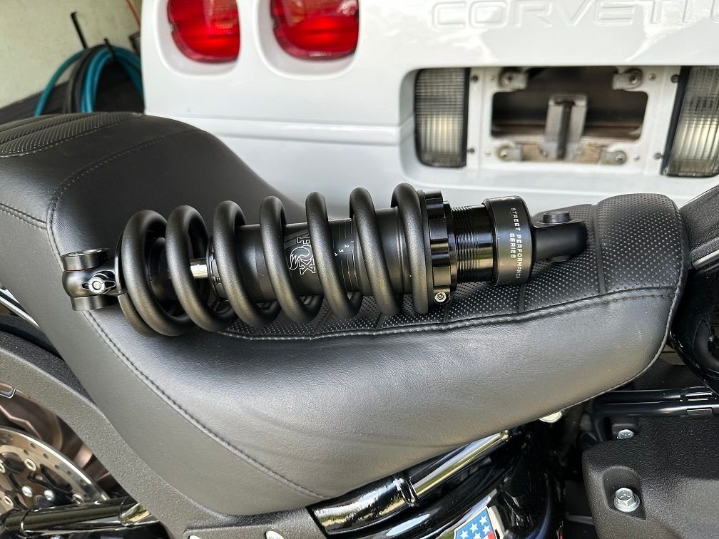

the Pre 22 LRS had the 12.6, the 22 up and ST have the 13" which sets the bike about an inch higher...
Stock shock
Fox 12.6
