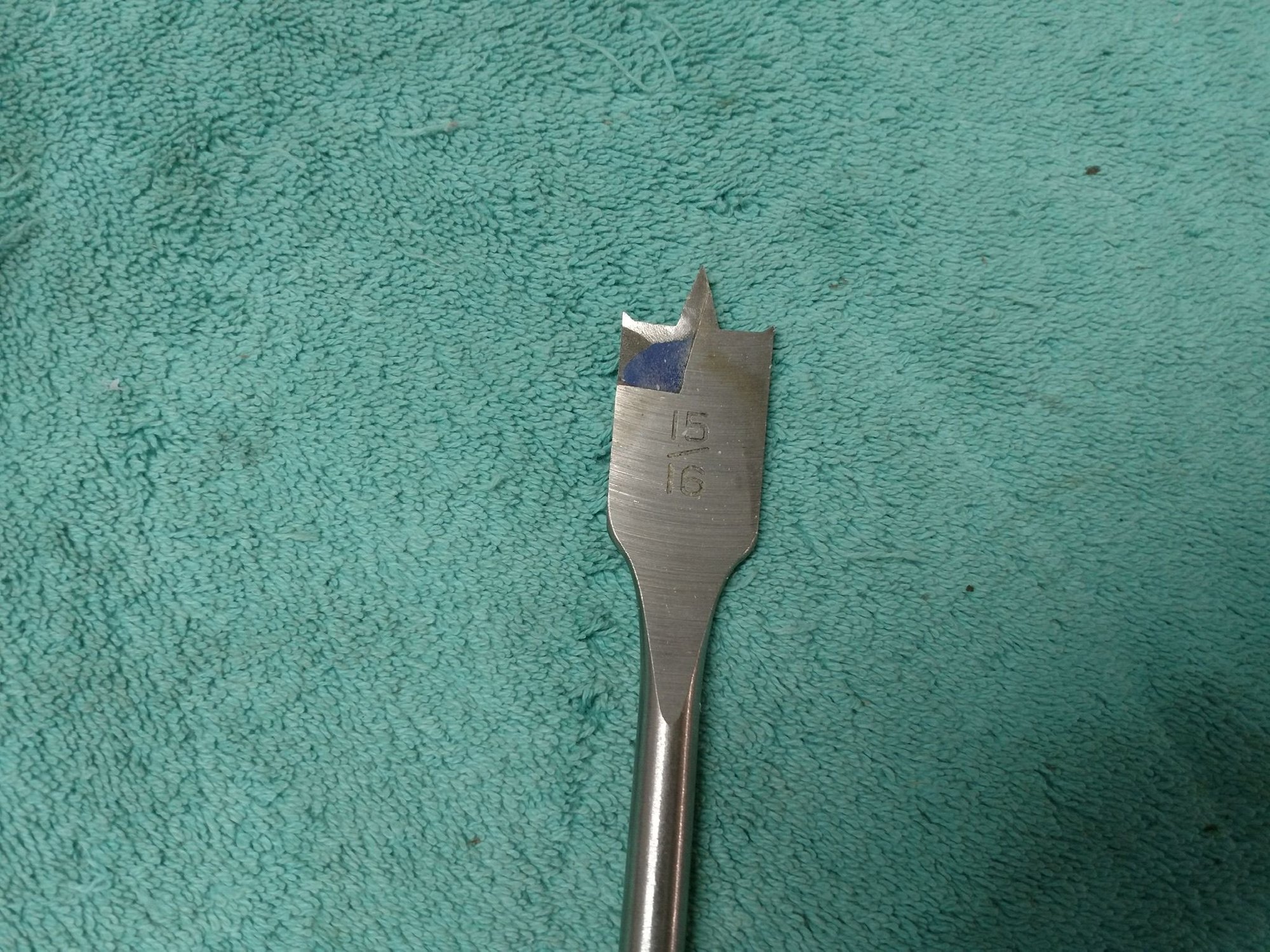

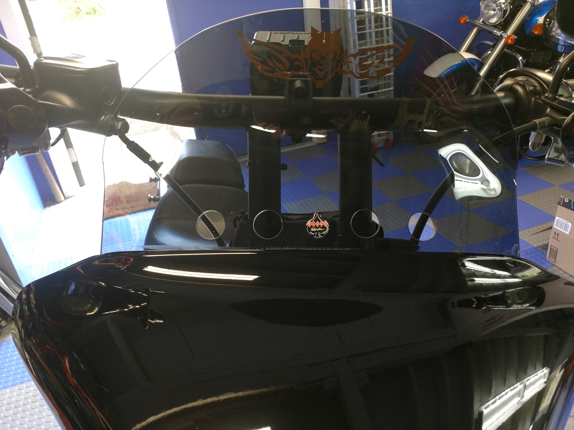

I was wondering how the vents worked to quell turbulence on the Rushmore bikes so I vented my Klockwerks, this has helped tremendously and I do recommend this modification

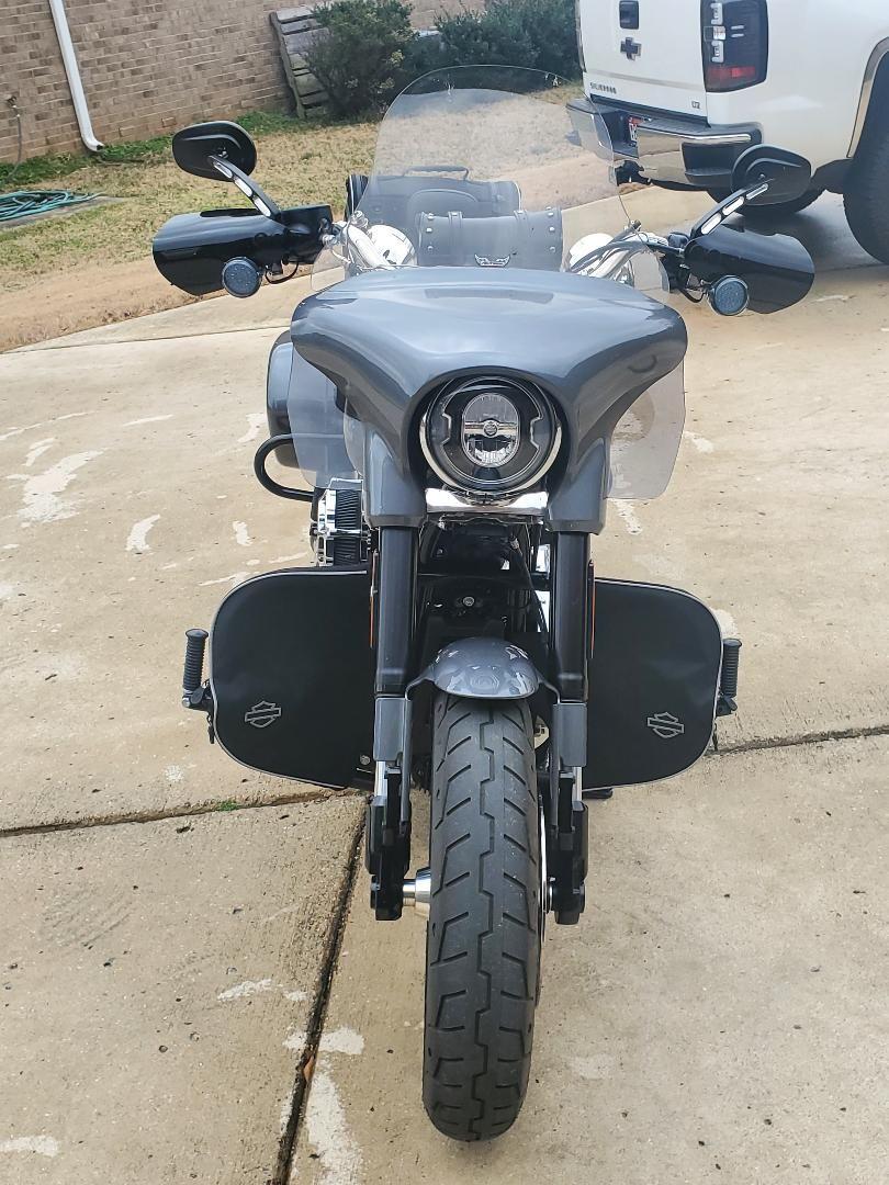

This shot shows the Gustafson 15" vented. This works way better with far less buffeting than anything shorter that I have seen but still allowed some minor buffeting from air that came under the fairing and then up over the tank. After adding Gustafson's lowers (not pictured) it re routed the air that was coming over the tank out and around the bike.
