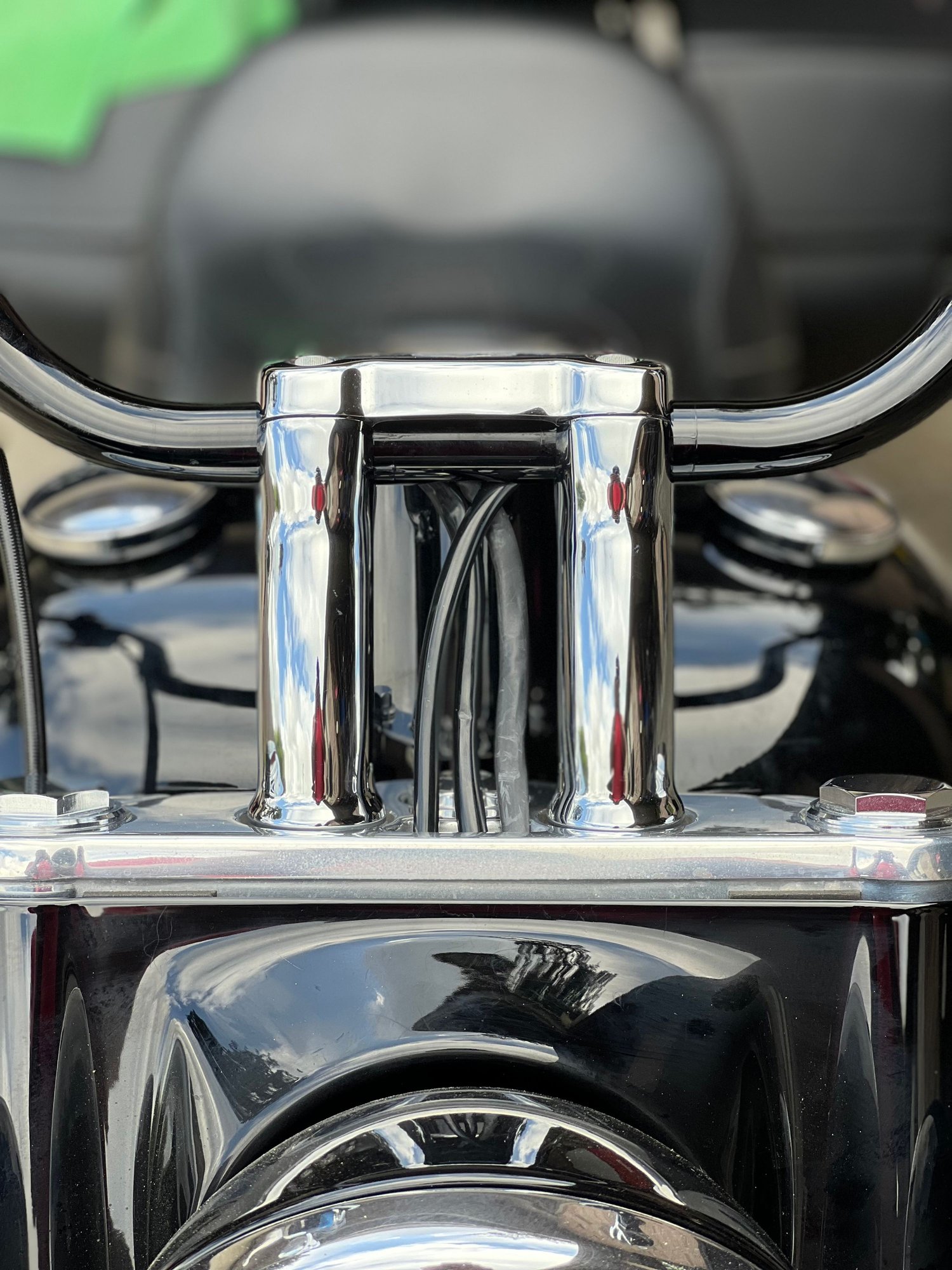

Old Apr 22, 2022 | 03:12 PM
GalvTexGuy's Avatar
GalvTexGuy
Joined: Apr 2015
Posts: 10,057
Likes: 5,316
I’m in the process of installing risers on my ‘20 FLHCS. I bought the risers first and I have them roughed in so I could figure out what wire extensions, clutch and brake lines I might or might not need. As it turns out, I needed all of them.
I have the upper brake line, adapter and two of the three wire extensions I need, but I’m still waiting on the upper clutch cable and one wire extension, which won’t be shipped until 6-14 and 5-24, respectively.
Here is a thread that might get you started on figuring out what you might need.
https://www.hdforums.com/forum/softa...andlebars.html
