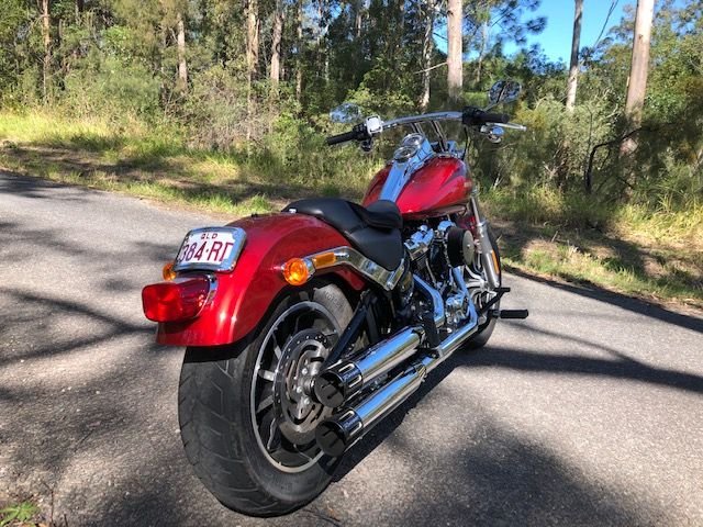

Installed my EBay Knock off HD copy forward controls, for the money $210.00 AUD you really cant fault them, only time will tell if they last the distance.
