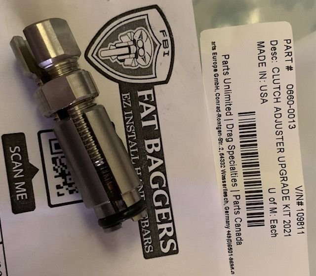

Glad I came across this post.. I went to 16" bars on my 21 RGS and used the fatbaggers EZ handlebar installation kit which worked great. The problem was, after I adjusted the clutch cable, when I pulled in the lever the red piece would pop out and I'd lose my clutch. The only way to keep it from popping out was to wrap it with small wire. It's not failed me yet but I ordered a new upper clutch cable for piece of mind which was a over a month ago. I'm going to go with the EZ clutch adjuster setup, seems to take all the flimsy plastic out of the equation..

$tonecold is mailing me his upper cable. A BIG shout out to $tonecold, much appreciated!
I had already ordered this before his post. I'm going stash this in-case the pos coupler lets go again. If so this is going in. I can handle adjusting the cable myself. My bike has been down for a week already and I don't like it.

Replacing with the whole old school cable is the best solution.

I just installed the EZ Clutch by FATBAGGERS yesterday. I struggled with disconnecting and connecting the two cables after watching a guy on youtube just compress the spring to get slack. I eventually did it correctly, removing the clutch lever to get plenty of slack. the divice is well made, and i'm not worried about another failure of that P.O.S. red thingy. COME ON HARLEY!!!!!!!

I installed one a while back, works great.

Mine was a tight fit too.
I never had a clip fail but trying to avoid any problems.
