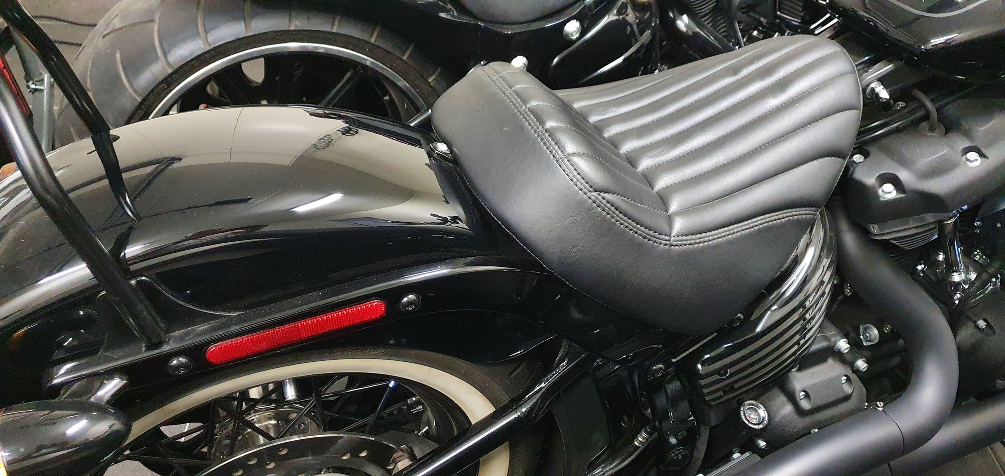

I powder coated them on my FXFBS and used regular paint on my FXBB, a + for the regular paint is that the torxkey still fit
Matte black pc
Gloss black wet paint
Regardless of which finish I do on bolts, I always "sand"blast these first, the advantage is that you don't really need a primer for the wet paint and you can instantly apply the base coat and a layer of 2K clear coat.
For powdercoat it is always needed to blast them first, the powdercoating is more sustainable but is actually way too thick to use on torx of allen bolts, on ordinary hexagonal bolts it is not that bad, then you just use
a bigger wrench / key, but that is not possible with torx and allen.
