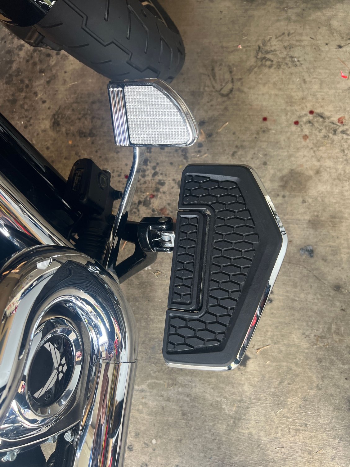

So I installed the heavy breather air cleaner on my 2020 Sport Glide and now I am having a issue reaching the brake pedal easily. Does anyone make a extended pedal or complete brake arm and pedal that is longer than stock?

I had same issue with my Sport Glide. I have ordered one from china, but still waiting delivery. According to tracking; in theory I should receive tomorrow. Let you know when I do receive if it works.

Sport Glide uses the Breakout lever, this lever uses the FLFBS/FLHCS/FLSL Break pedal and fits the Breakout.
So you just need to get this lever and a Fat Boy break pedal, and you'll be fine.
I have this on my fat boy with the willie g break pedal, fantastic upgrade.

Actually the new brake lever works for me. Moves it toward frame so my foot isn’t under it

Will adding a 1" or 2" longer brake lever help me get to the pedal? right now to get around the air filter I have to turn my foot in towards the bike which is uncomfortable. really just looking for a pedal that comes farther out from the bike.
