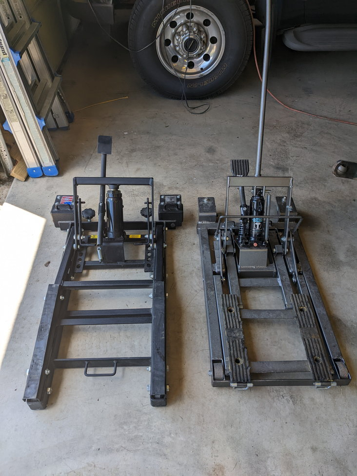

Workable options are more plentiful for the touring models. The Softails and Sportster are more challenging because of the jiffy stand location and frame height clearance. From where I sit, I only know of one jack that works well/is worth your time... That would be the J&S jack.
On the left is a J&S. On the right a Titan MPJ-1500. This picture clearly shows one of the issues you'll likely find with typical jacks you might come across. The bar on the leading edge of the Titan is an issue when it comes to clearing the jiffy stand (especially on Sportsters). So is the leading crossmember between the rails. Two other things that make the J&S supperior is the width of the rails and the fact that the lift support members are nearly veritical when the lift is fully up. Not so on the Titan. The Titan support members are still at a considerable angle producing more leverage and less stability. Both my Heritage and (especially) my Nightster are rock solid on the J&S jack. Not so much on the Titan (both can rock considerably).
Other performance differences between the two - lowering speed/control and rolling the bike around. The J&S wins hands down.
Perhaps another consideration is the bottle jack. Most of the cheaper jacks have bottles with pin through type rams. If you ever have to replace the bottle, it may be difficult to find a replacement for the bottles with pin through type rams. The J&S jack accommodates generic screw ram extensions, pump handles, and release screw making finding a potential generic replacement much easier. You could probably rebuid either, so there is that.
J&S jacks are expensive. I'd recommend searching CL or Facebook MP for a used one in good shape to save $$$.

Yes. I've done that too. Not a great solution. In my case, when lifting the Nightster this way, I'd have to put the jiffy stand up which lead to another problem... The jiffy stand mount (and the bike's weight) would ride on the crossmember between the rails. Not good. Better to have the bike's weight on the actual lift rails. Other lifts may vary... But for my use and expectations, the Titan had to be replaced and I wasn't going to screw around this time. Bought the J&S jack. All problems solved.
