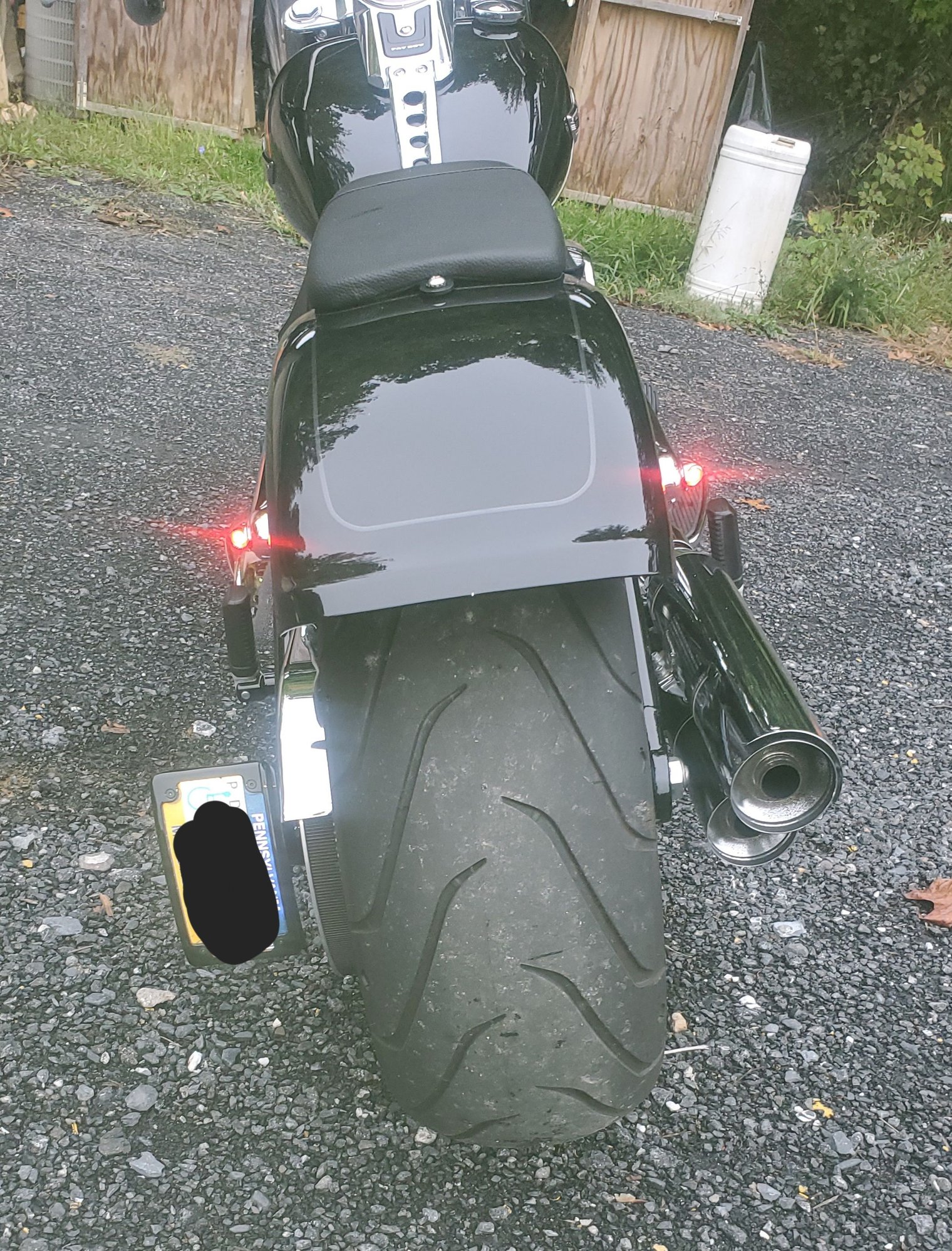

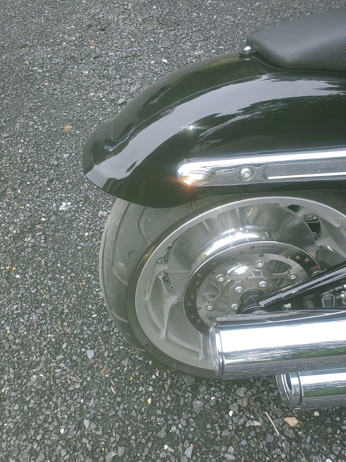

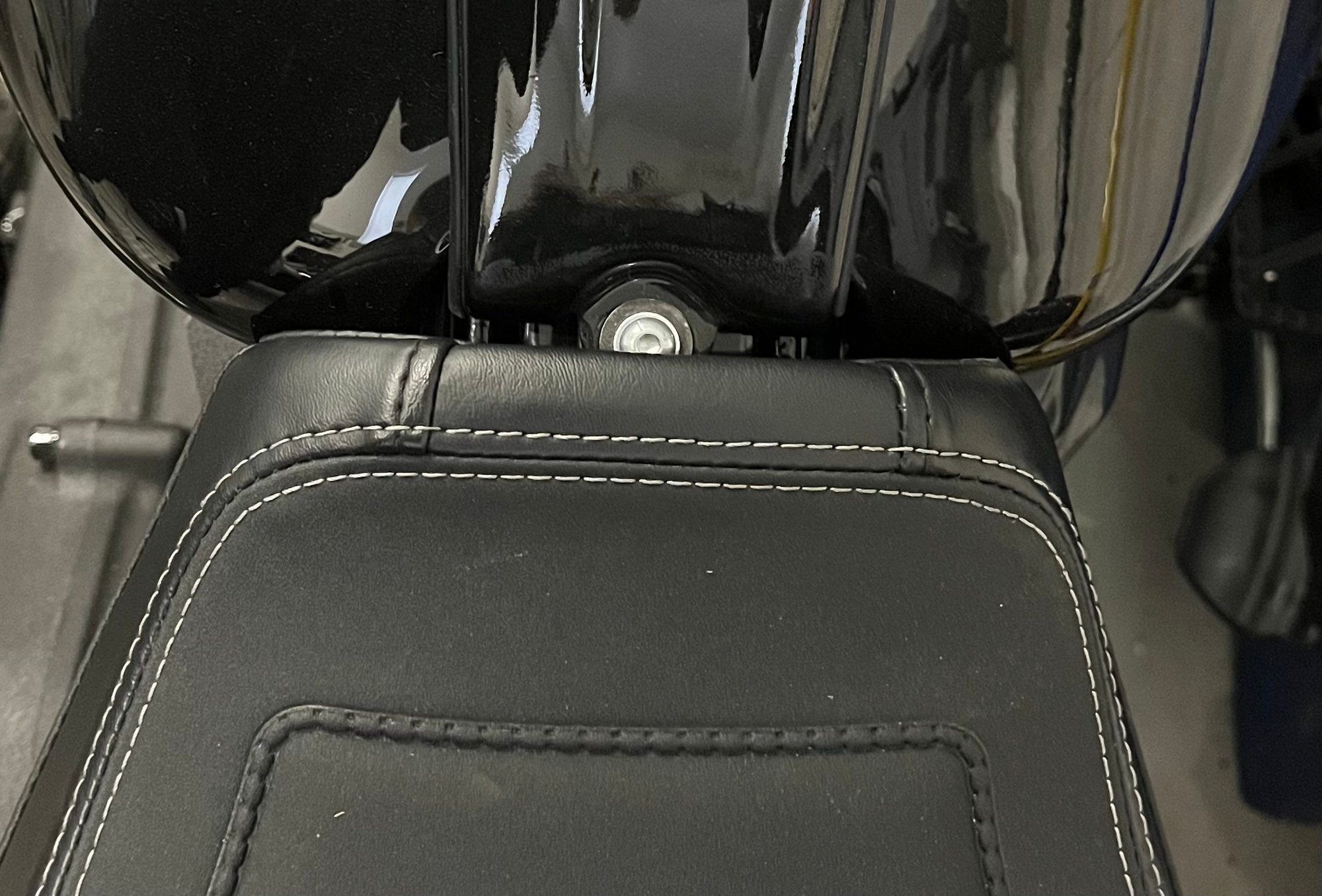

you’ll need everything mentioned…. Stock seat fender, struts and also the fat bob nut plates ($12) and 3/8”x16 thread strut bolts. I got the lighting done but now have to decide on my license plate location since I don’t want it attached to the fender. I’ll post up some under seat pics once I get that figured out. It fits fine but the to forward corners of the seat slightly rub on the tank and also leaves the tank dash bolt exposed. Probably going to undo the front leather on the seat and trim corners and then maybe add material to cover over the bolt.

The seat concern I would have is this...did the fender move you forward any ?
I recall trying my badlands seat on a fat Bob and the shock type and location seem different.
It seemed like the fender under the seat had a Hump that pushed everything forward.

it did but only a little, however I was looking for that change being shorter. The fender and struts are shorter than the lrs and designed to work with fwd controls that a fat bob has.
If you don’t want a sporty aggressive feel/position and looking for more comfort then this probably ain’t the route you’d want to take. My RGS handles those duties instead.
I’m most likely gonna figure out a axle mount solution for the plate to keep my bag where it is and the clean fender look going

I noticed a small vertical line on your back tire. Not sure what it is but thought I’d point it out in case it’s a cut or defect of some kind.
Thanks for looking out and good eye. I checked and it was just the seem between the garage floor mats along with a bunch of road salt/dust to make the impression of the floor on the tire.
