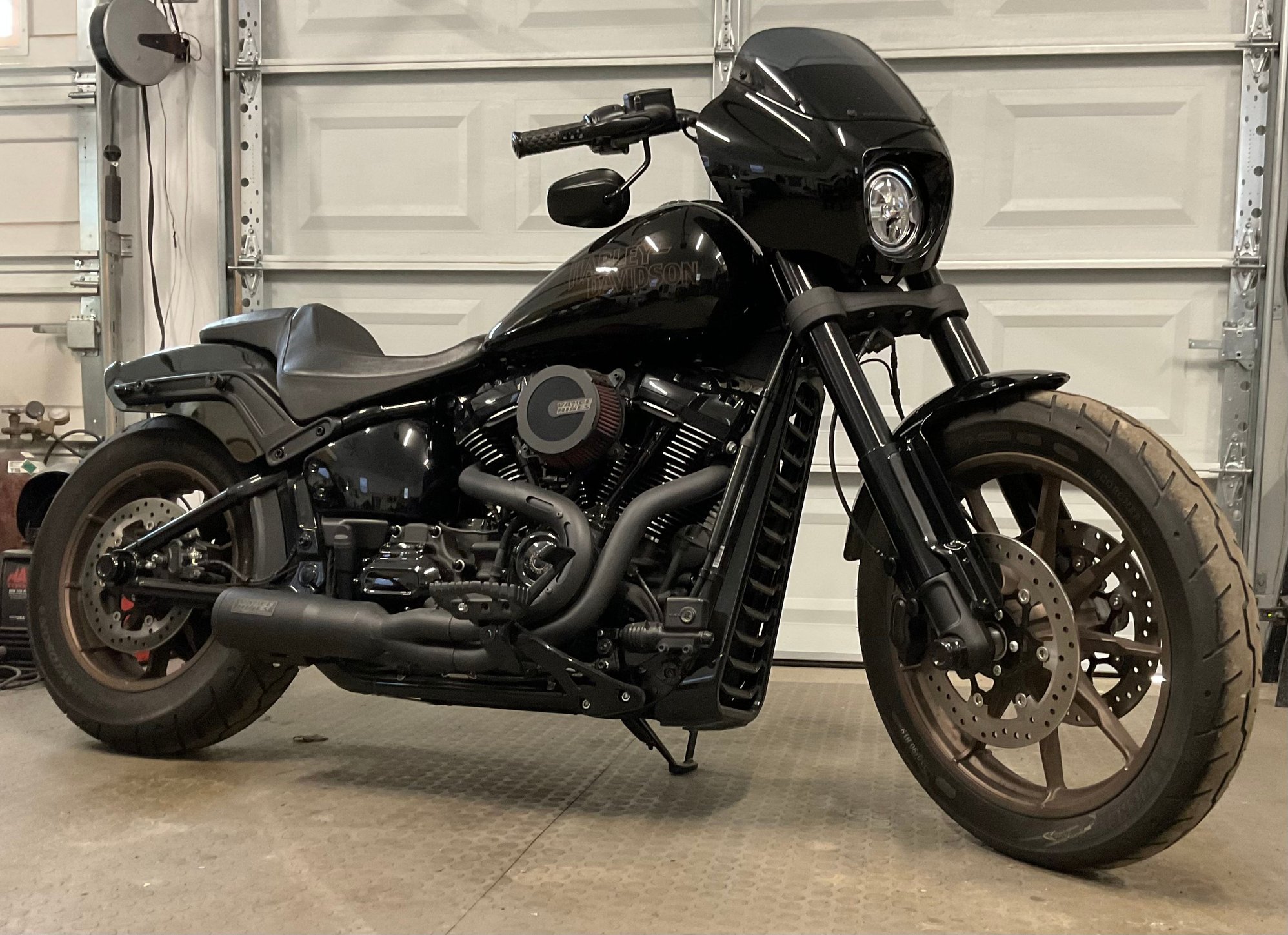

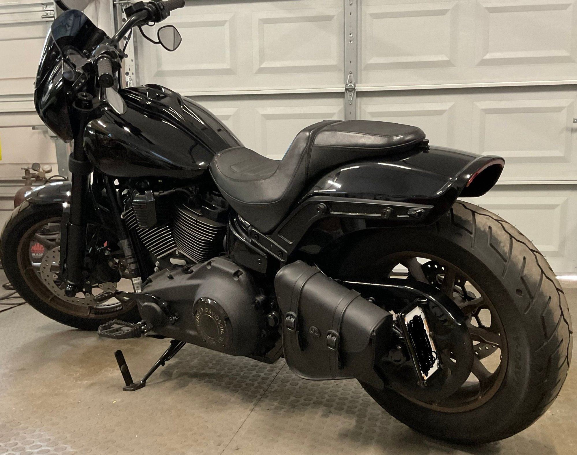

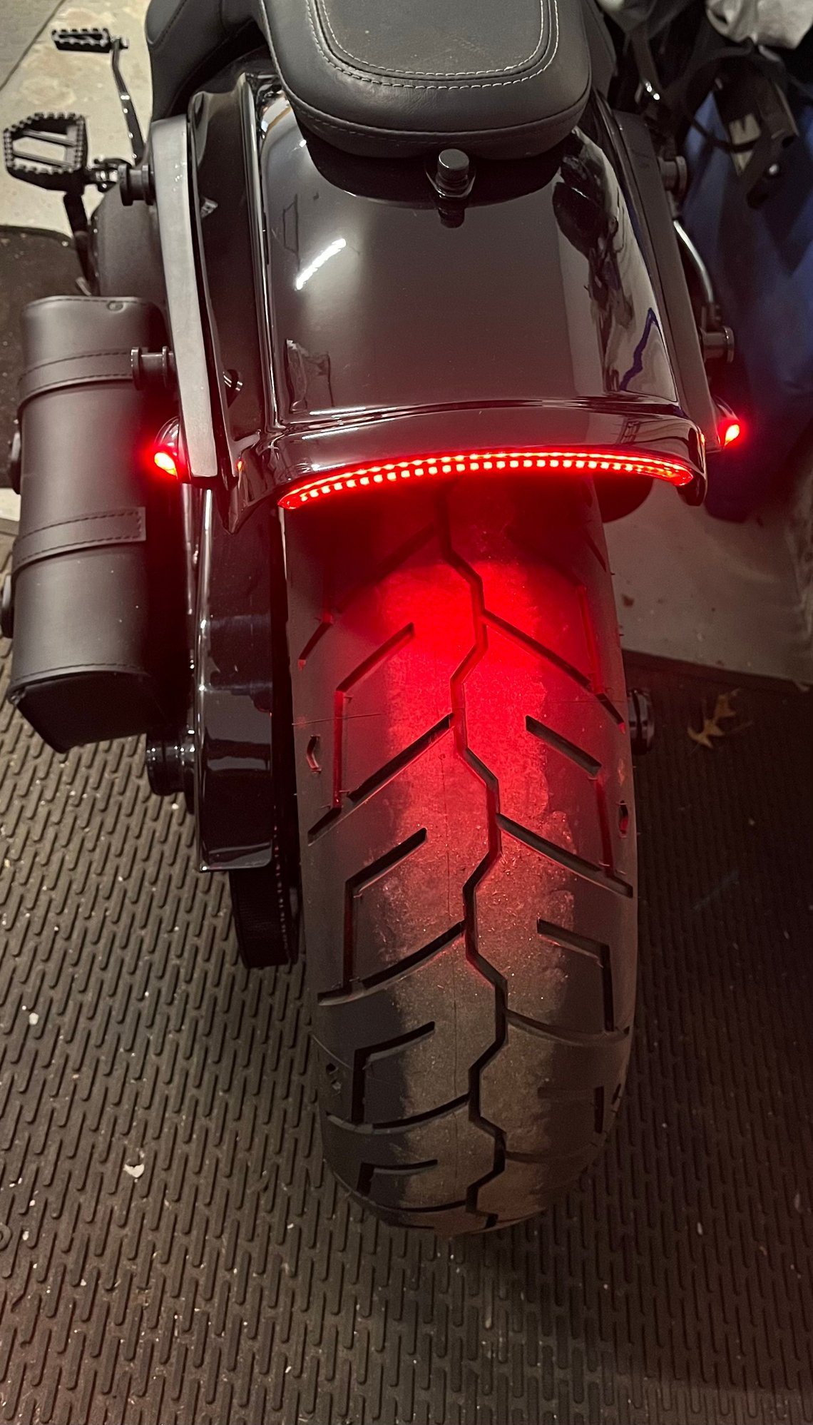

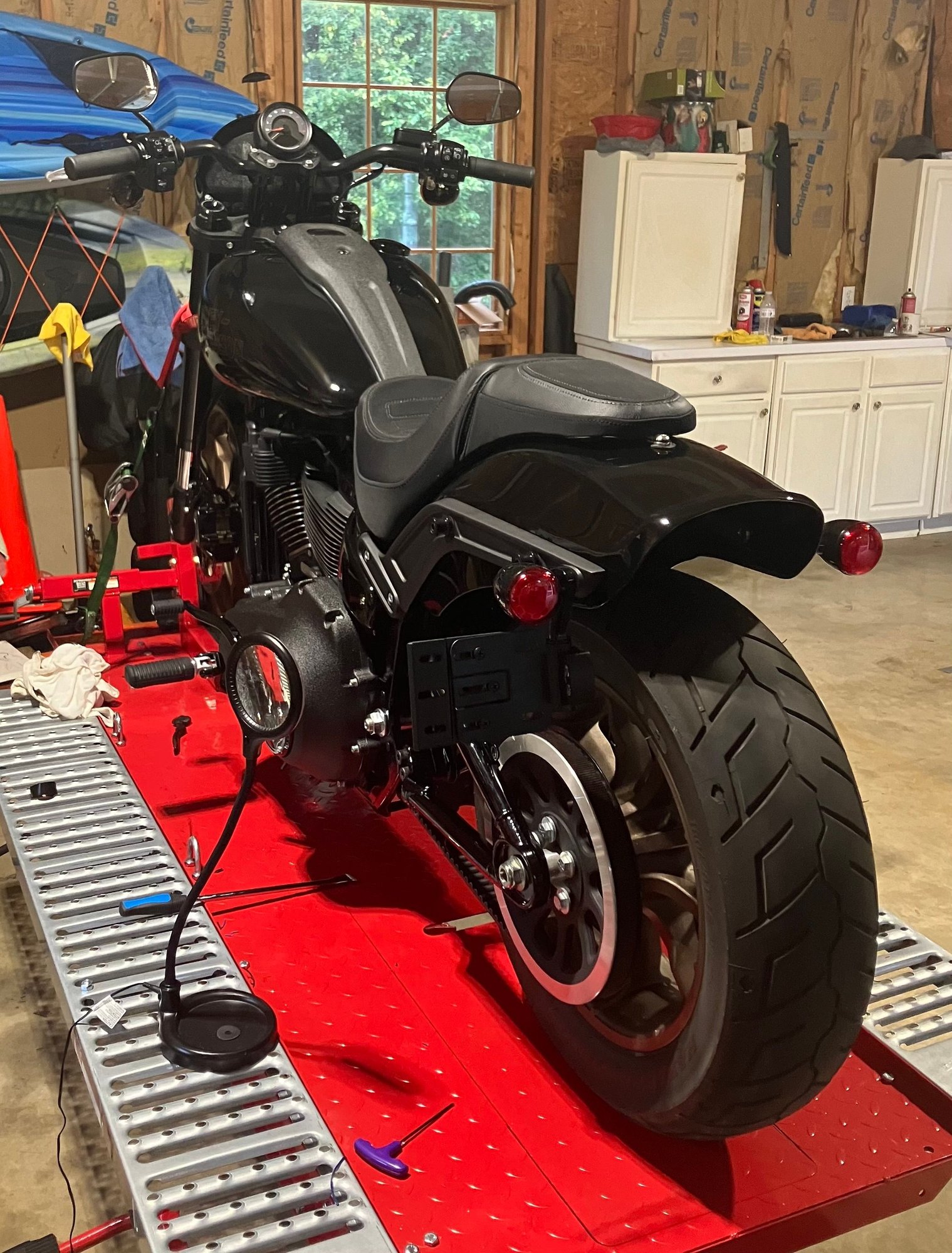

All wrapped up. Gonna be a long few months now counting down the days until Spring, but will give me time to fab up a short quick release sissy bar to strap a weekend pack to if ever needed. Will also be fab’ing a small section of vinyl covering to hide the tank dash bolt by the seat that’s exposed now. LRS stock seat has extra material and cushion at this area to hide the bolt.
For anyone considering any like conversion, know that the LRS has a separate brake light connector while the FatBob has it’s brake wiring within the smaller two turn signal connectors (No third larger connector). Without 4 wire turn/stop side markers and splicing you’re SOL. I have the added center for daytime running and turn and spliced separately for the license plate white led light to work. Even added the custom dynamics strobe for the brake lights to give myself that added chance of avoiding stupidity running into the back of me. Lastly, I used VHT black vinyl die spray on the seat to eliminate the white stitching that clashed badly with the rest of the bike. Almost forgot. To use the dominion axle cover with the plate bracket, you’ll need to grind down and repaint it to fit inside the bracket with enough room to still secure and cover the axle.

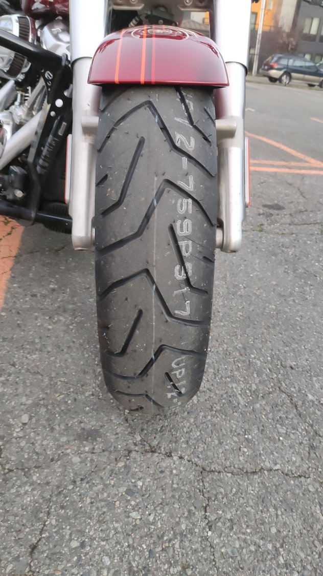

Originally Posted by Jecr
Nicely done! It’s a good look imo, an aggressive look.
I noticed a small vertical line on your back tire. Not sure what it is but thought I’d point it out in case it’s a cut or defect of some kind.
That's a Static Discharge strip.
All motorcycle tires have them.
You can see the one in my front tire in this pic that has literally less than a mile on it.

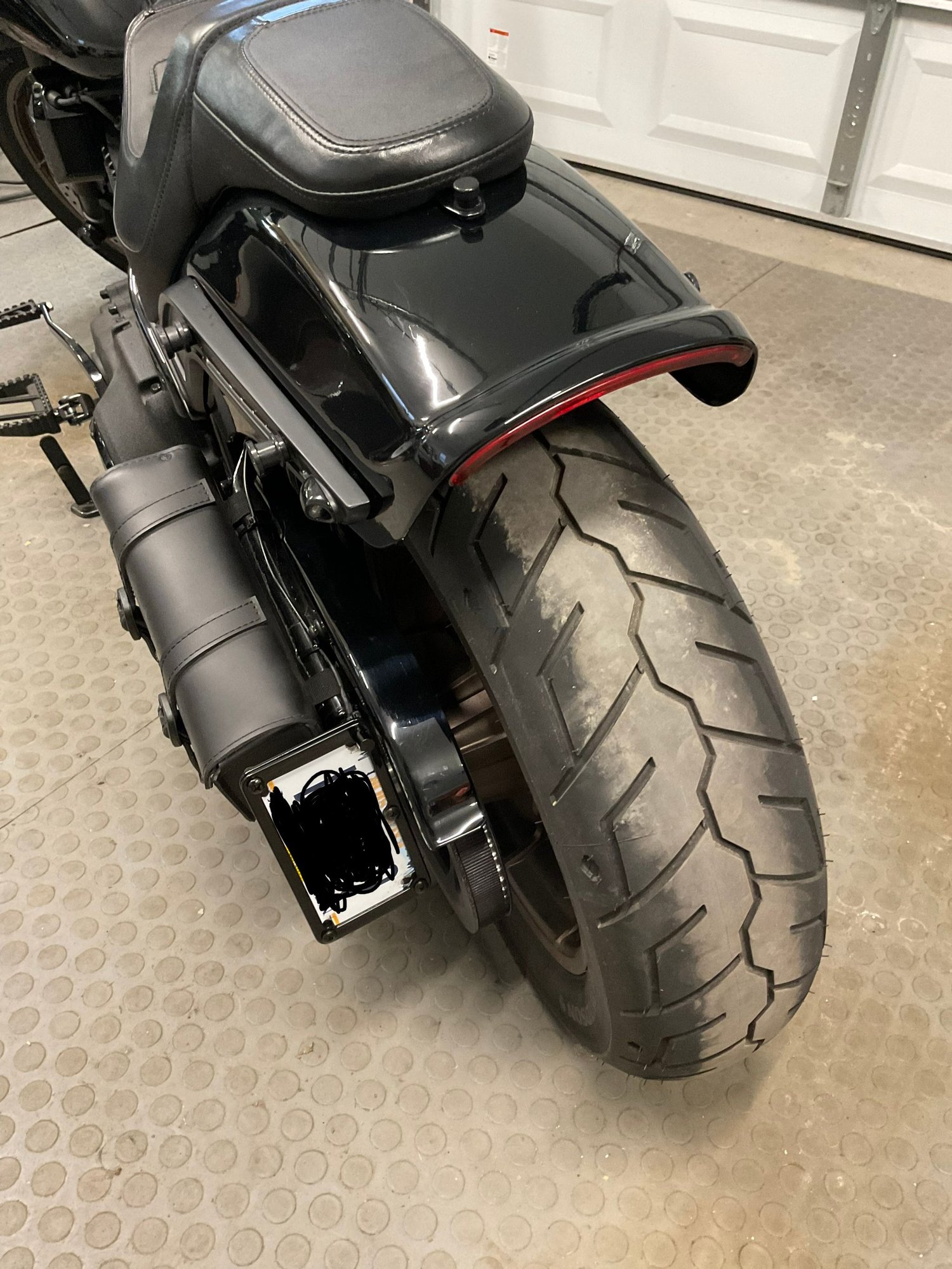

[QUOTE=WellAimedRound;20975903]What happens when a low rider s slams into a fat bob…..This! Just test fit for now until slight paint and front seat section mods are complete along with led mini lighting to be added. Just gotta figure out where to put the license plate since I like my swingarm bag where it is.
This is so cool. I've been think about doing this exact thing and now that my FXLRST is almost ready for the highway I'm in the planning stage for a second bike that's stripped down for around town. I'm curious about the fender and how off center it looks. Is this an optical illusion, is something bent or loose or what is causing the weirdness? I was planning on skeletonizing the struts by cutting out the concave parts, but maybe they need to be remade and shifted to the side. About the license plate, I'm hoping to mount it above the fender like a muscle car spoiler. Since it's been a few years since this post maybe we can hear from the builder. Kudos!
Old Sep 14, 2024 | 08:26 AM
WellAimedRound's Avatar
WellAimedRound
Joined: Nov 2021
Posts: 84
Likes: 65
From: New England
This is so cool. I've been think about doing this exact thing and now that my FXLRST is almost ready for the highway I'm in the planning stage for a second bike that's stripped down for around town. I'm curious about the fender and how off center it looks. Is this an optical illusion, is something bent or loose or what is causing the weirdness? I was planning on skeletonizing the struts by cutting out the concave parts, but maybe they need to be remade and shifted to the side. About the license plate, I'm hoping to mount it above the fender like a muscle car spoiler. Since it's been a few years since this post maybe we can hear from the builder. Kudos![/QUOTE]
This was just the mock up before final install. Went with an axle mount license plate holder.
Old Sep 14, 2024 | 05:22 PM
HS3's Avatar
HS3
5th Gear
Joined: Sep 2024
Posts: 9
From: P-TOWN
Nice and clean. I'm looking for an aggressive seating position, how does this compare to the original position. Any issues with the fender, struts, seat, gas tank fitment that you'd warn me about? Do you think the street bob or fat bob tank would fit better?

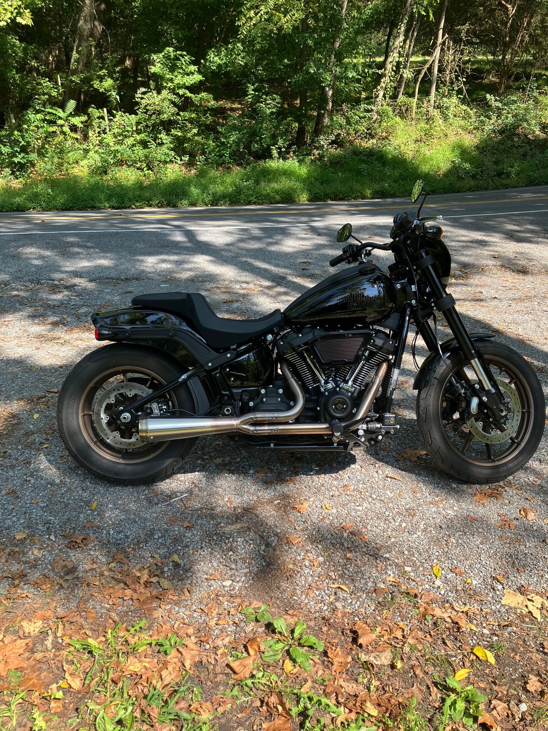

WellAimedRound, I used your research and install to Fat Rider my FXLRS. I posted in the what have you done thread, still wanted to thank you personally. The lighting and the tag were the biggest PITA, the fender bolts right up.
I went with an Amazon Fat Bob tag -
Cheap tag bracket Cheap tag bracket
On the lighting went with a Custom Dynamics triple play box and pro beam leds.
WAR, I really dig the bike now, seating position is perfect (I’m a little dude) saved me from installing pullback risers too.
Thanks again dude.
