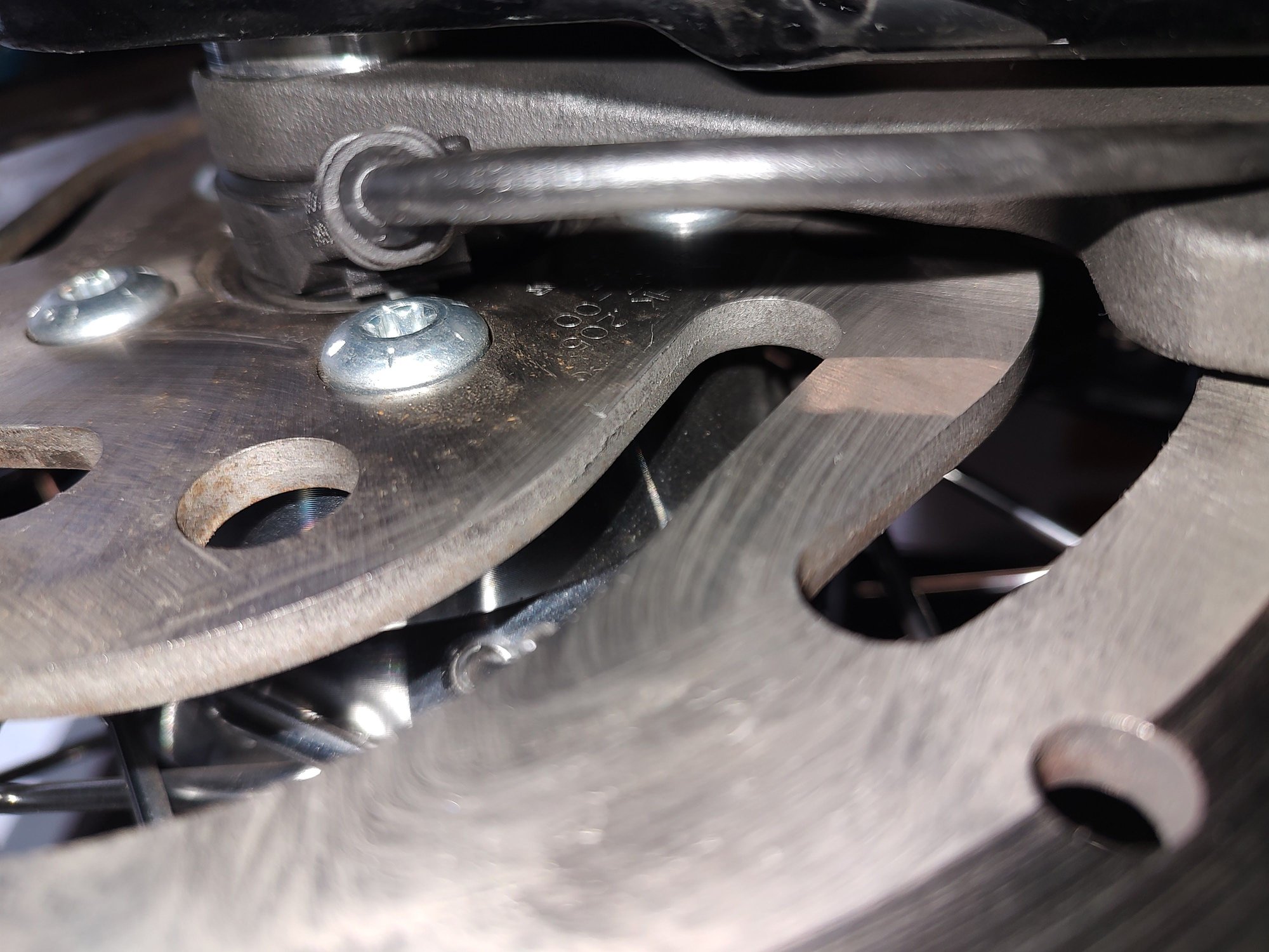

Hey folks. Got my first ABS bike. I figured I'd be here after this...Took my wheels off to get tires mounted. After getting everything back together my ABS light is flashing. I pretty confident I have them indexed correctly but maybe I didn't. Note, I have not taken the bike out for a ride yet - only started it in the garage. Here are pics of my sensors. Did I mount them incorrectly? Or do I simply need to ride before the light goes out? The wires are not pinched at either sensor.
Thanks for any input!

Until both wheels have been turning for a few yards the ABS light will stay on. It is normal.
So you have never started and ridden the bike before and observed the behaviour?

The ABS light will flash every time you start the bike, then it will go out once you start moving.
Unless there is something wrong!

Thanks guys, I wanted to be sure the sensors were correct. I do have a service manual and followed the procedure but have never had an ABS bike. And yes, I've noticed that the abs light flashes when you start up the bike but I've only had it a couple weeks and about 300 miles. My recollection is that the light flashes upon startup and promptly goes out after the bike is running.

The sensor does not look like it is installed correctly Mine is not a 2018 but the nipple fits in a grove.

Your sensors look fine.
