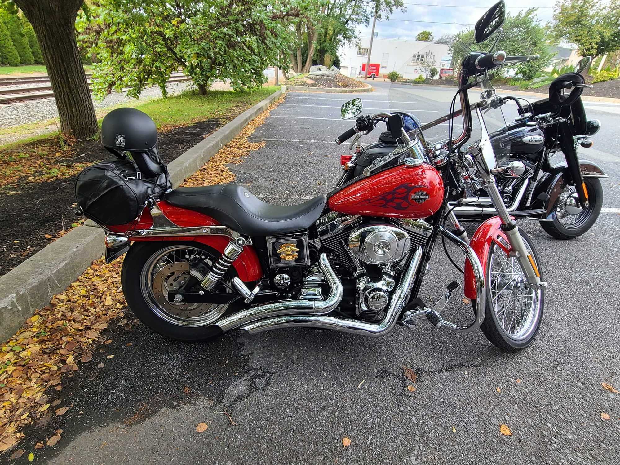

One of the bikes I rode while doing my research was a 21 Fat Boy 114. It put me back in the seat and took me down the road like nobody's business! For other, more important reasons (to me), I chose a Heritage instead - a 2019. There are so many factors that go into really enjoying a bike. You can't just search online and/or walk into a dealership and be stricken with excitement and sign the paper an hour later. That's a start but it has to be a feel. Like a pair of pants. Let's face it, we all have 4 or 5 pairs of jeans in our closet, the same size and style. Tell me some don't different. That did happen to me when I saw my 02 Wide Glide. Anyway...
