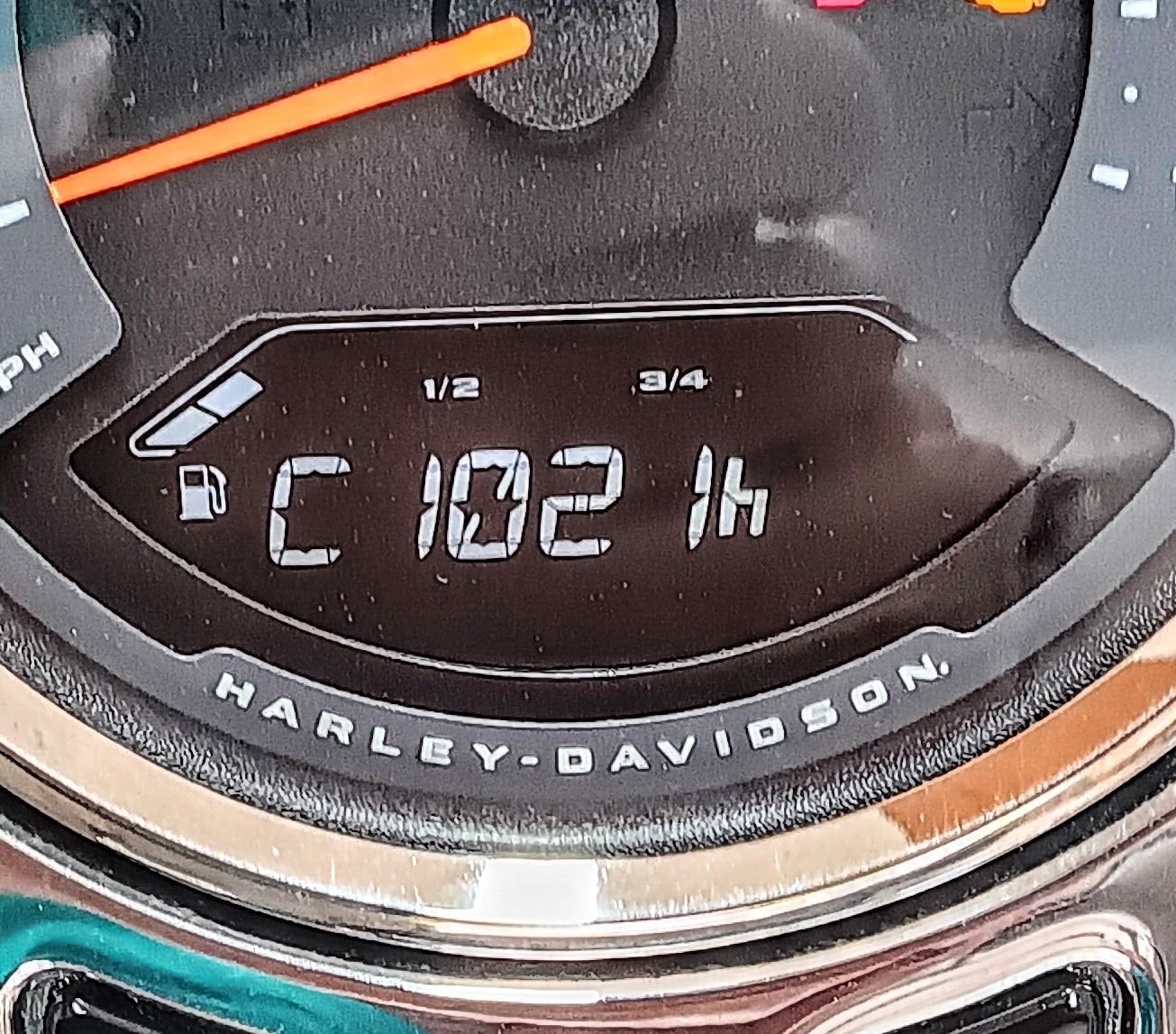

I didn't get any lights, abs or check engine, but this morn I was just checking the codes for no reason on the 2021 Faboy, and I got an ABS Y. So I held it, and it threw C102 lh, I did a search, and don't see anything on it. Anyone know?
I do a panic stop every couple weeks for practice, and it seems to be working normal, no lockups.
My guess is when I added a pullback riser over a year ago, I replaced the front brake hose with a longer one. I did a vac bleed, and all was well, worked fine, and no lights. Maybe the diag picked something up. I'm thinking of clearing it, and see if it comes back, but thought I would check here first.

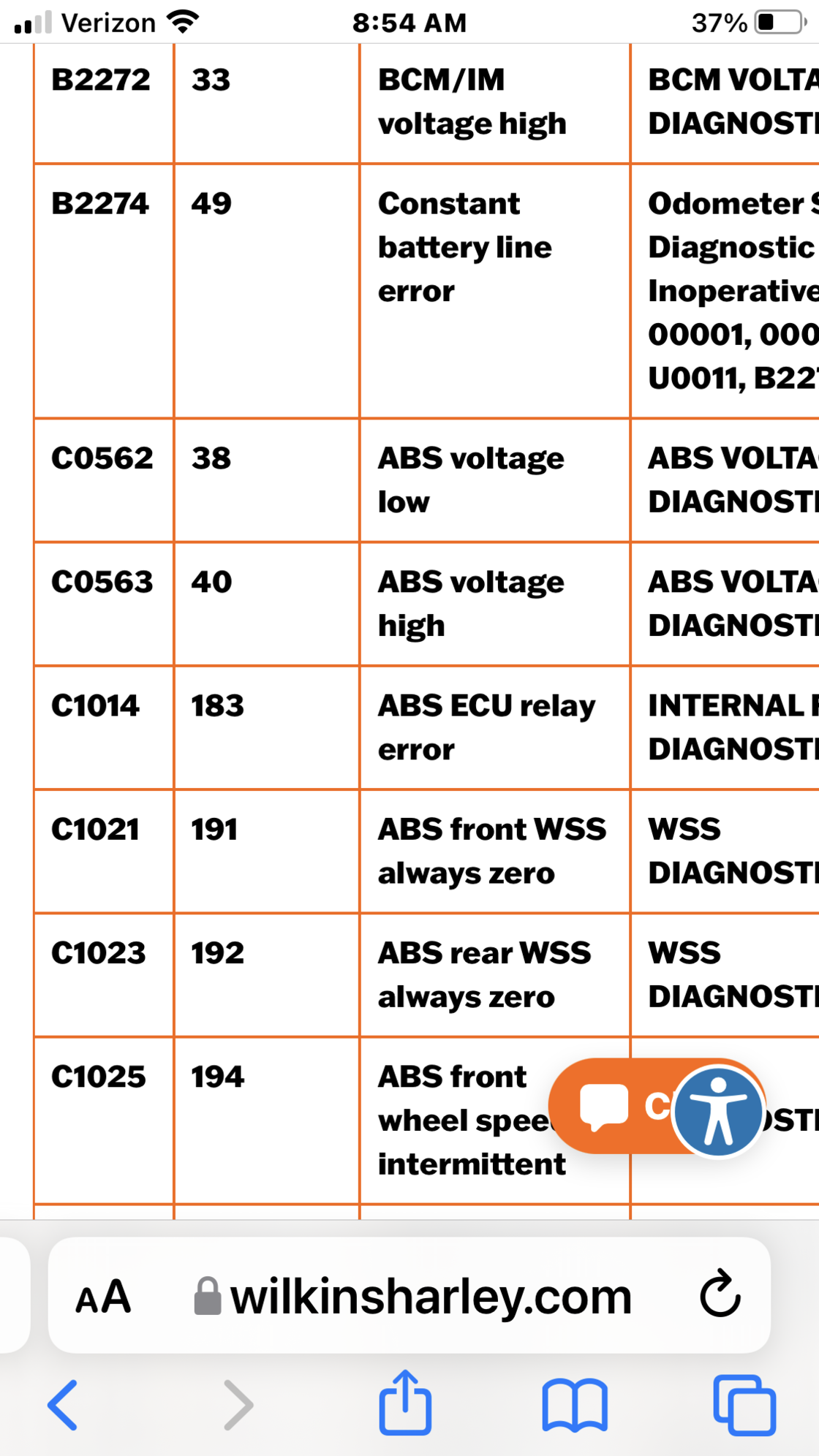

Old Mar 11, 2023 | 08:09 AM
Kenelz's Avatar
Kenelz
Joined: Nov 2021
Posts: 479
Likes: 319
From: FL winter, northern MI summer
OK thanks! It looks like it really means C1021 h, not C102 lh. It must mean a historic code not active, I should be good to clear it then.

I just found my answer doing a search, and on another forum this came up ".......DTC (C1021, Front WSS = 0). This same code will set if the bike is run on a dyno."
I had it Dynoed last week.

Old Mar 11, 2023 | 10:26 AM
FranBunnyFFXII's Avatar
FranBunnyFFXII
Veteran: National Guard
Joined: Oct 2018
Posts: 4,347
Likes: 3,392
From: Seattle
Yes H is historic.
I had one show up for an oil pressure sensor, never had it happen again.
Old Mar 11, 2023 | 02:01 PM
stormin08's Avatar
stormin08
Joined: Nov 2022
Posts: 802
Likes: 394
From: Missouri
A dyno event will throw that code since the front isn't spinning.
Again, any "h" is a code from previous...a "c" indicates a current issue.
I have had a BCM code pop several times...the stop/run switch keeps throwing a code...I started watching the switch and two things happen...
1. I bump into a partial engaged position
2. Larger bumps cause it to rock into a partial position
Trying to see if it is me or the switch and have the dealer order new if needed
