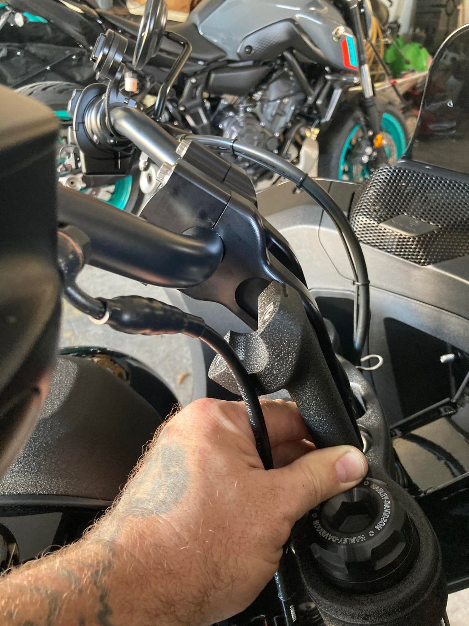

Quick question for us slow pokes, that would be me …. At what hight riser do we need to worry about wires and cables?
Old May 9, 2023 | 01:21 AM
Durham man's Avatar
Durham man
Joined: Mar 2017
Posts: 3,321
Likes: 1,884
on 20-21 models you can go up to 6.5. You have to reroute clutch cable. Turn down brake line banjo fitting. Pull a little of the turn signal wire through bars. Very easy install. Drag specialties are cost effective for 20-21 models. 6.5 will be maxed out. 5.5 is a more common size as it is a little less stress.
