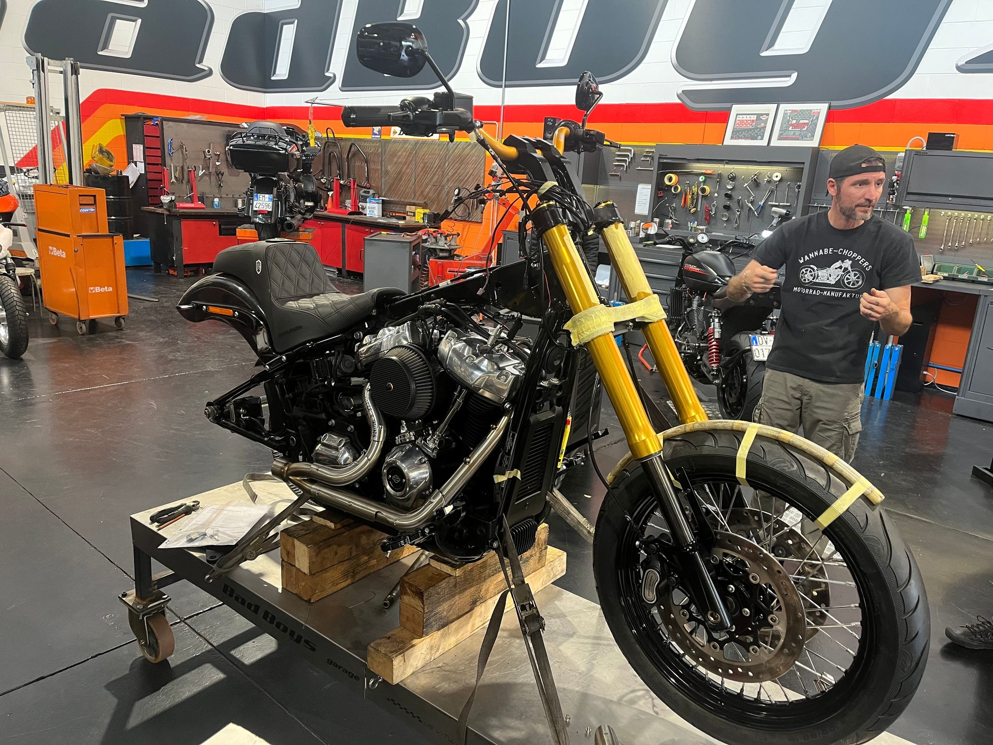

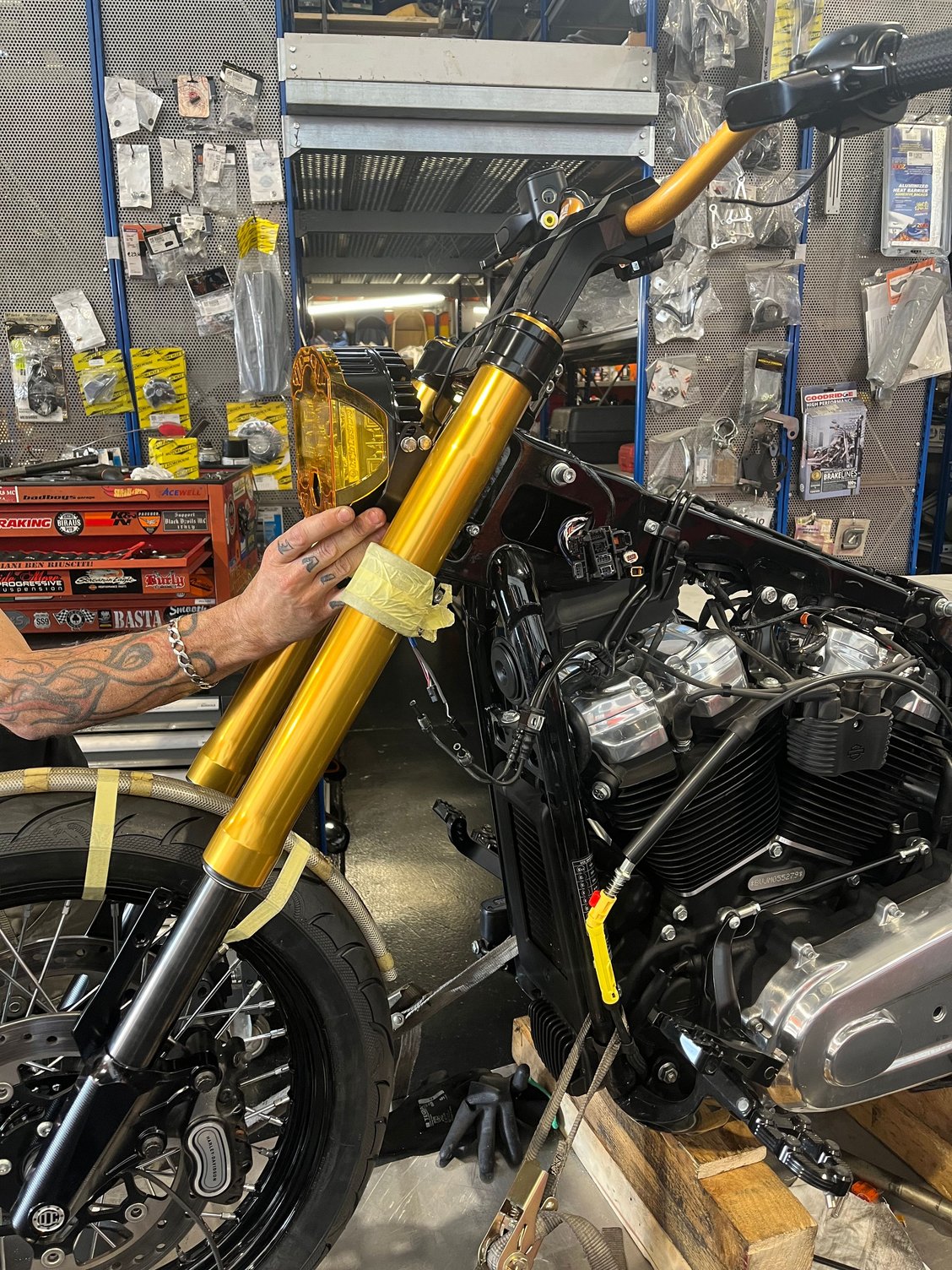

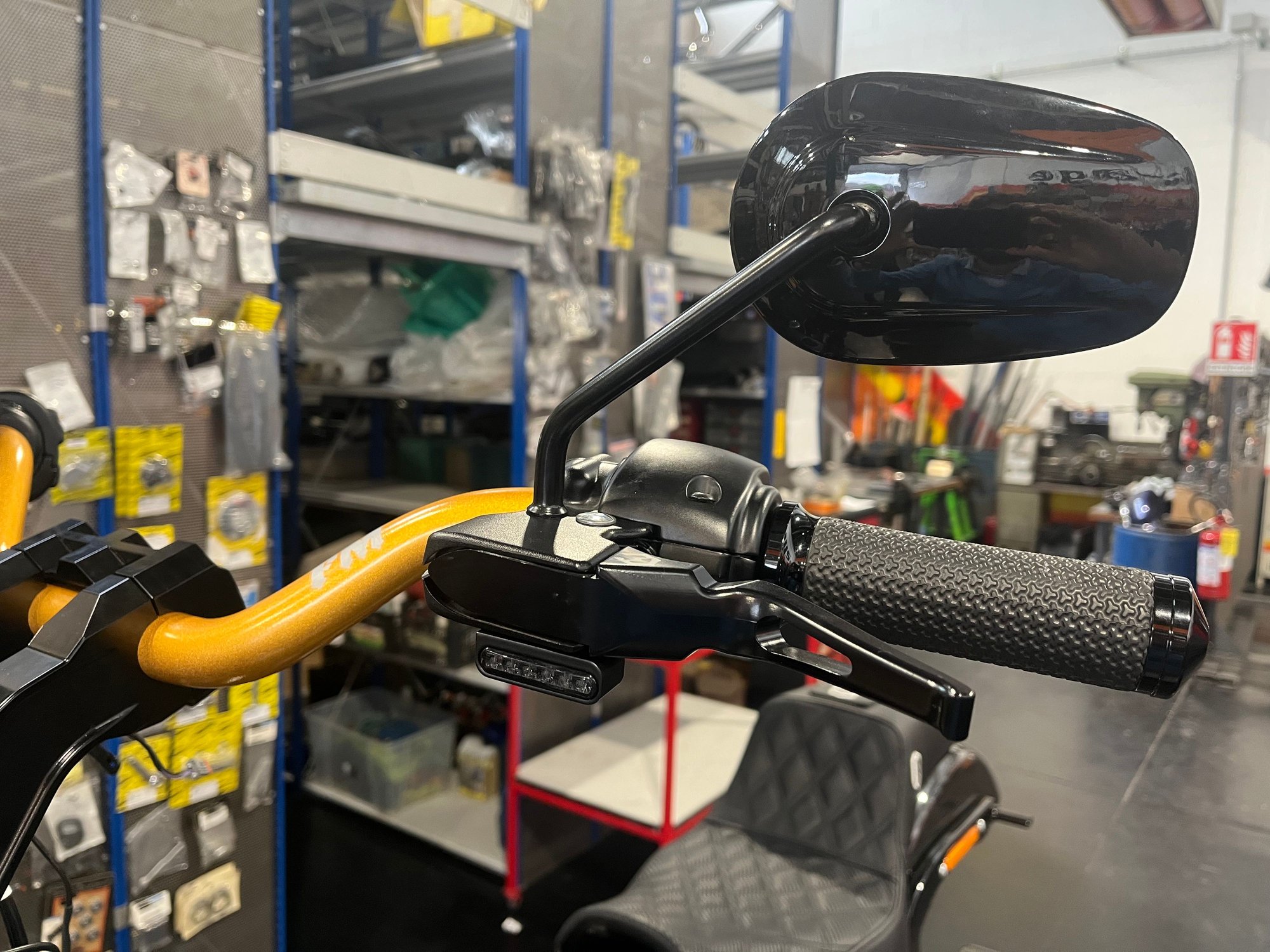

By now I changed the front end with one from ODC Suspension (an italian manufacturer that makes wonderful parts strarting from scratch), double front disc (everything coming from an LRS), Original Garage 6.5" risers, high rise Forbidden Moto bar, forward controls with Arlen Mess pegs and Crossthread Cycles levers (also hand ones) and some carbon fiber parts form HCP Carbon (also from Italy):

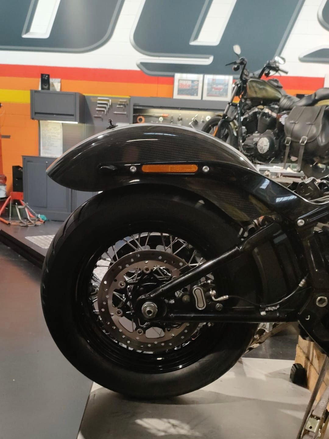

Now we're working on how to fix the Baja LP6 (I saw the Cali Raised solution but the light seats too high for me), the TRASK 2 into 1 exhaust and the rear tyre and licence plate.

The hubs are the original ones only powder coated. I just changed the rear rim with a 4.25” wide in place of the 3”. A couple of spacers were needed in the front to have the rotors aligned to the new position of the calipers in the front end.
Yes the discs and right caliper are coming from an LRS. I’ll swap them in the future if I’ll decide to change the wheels also.
