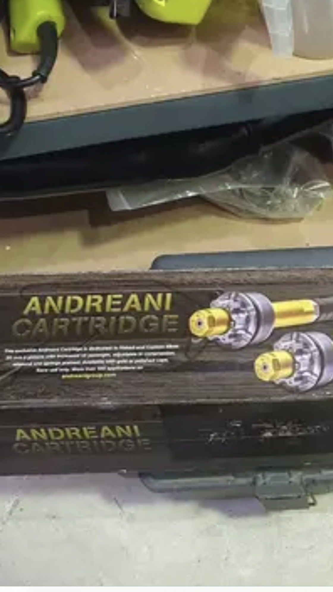

I am also looking at the more cost effective Andreani.
