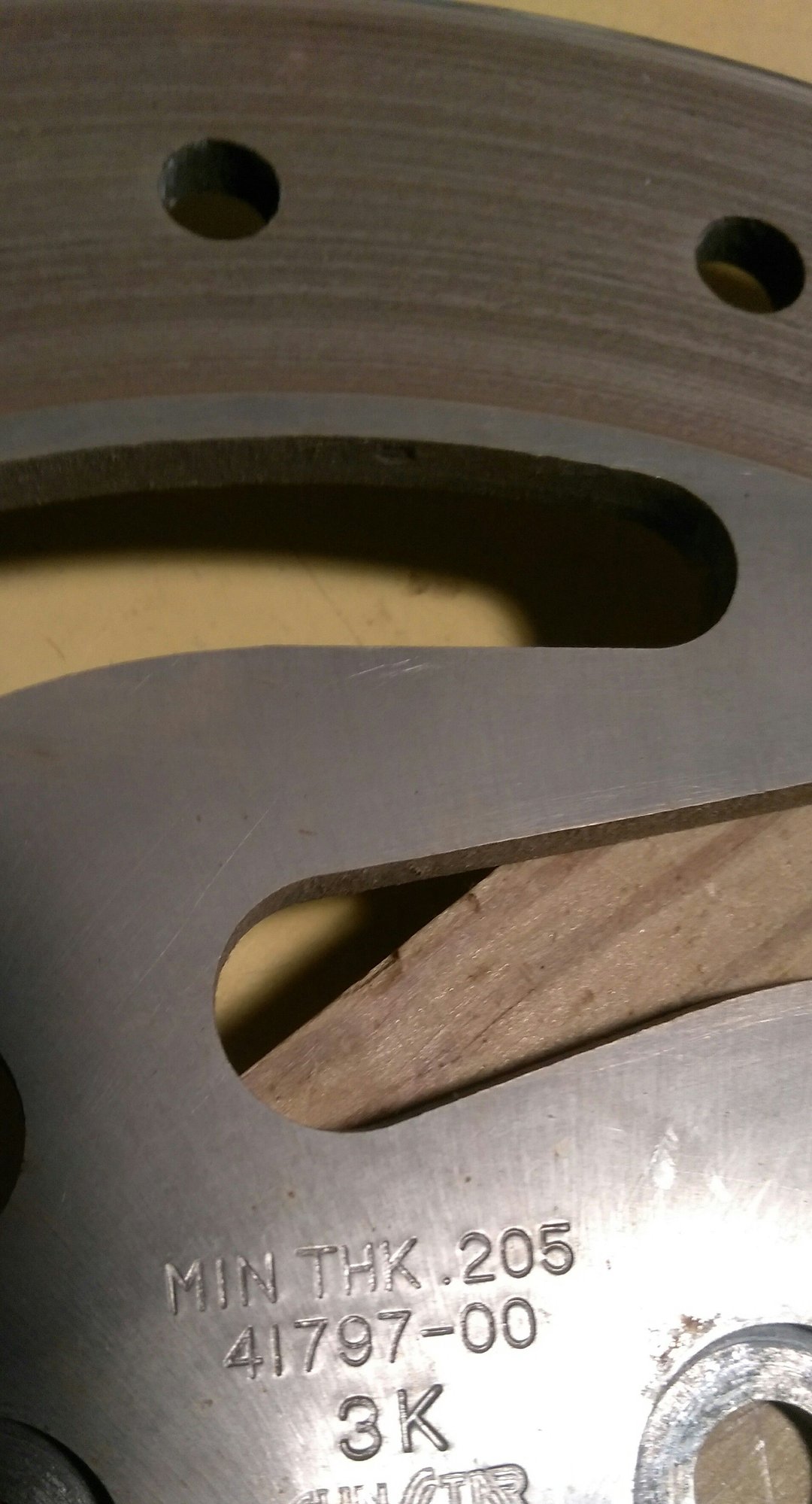

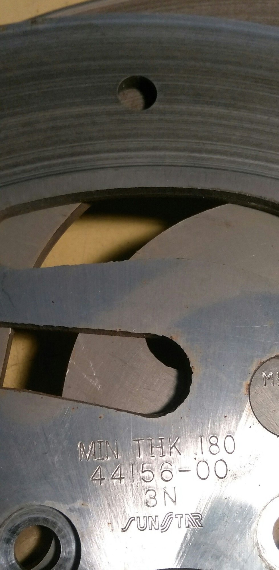

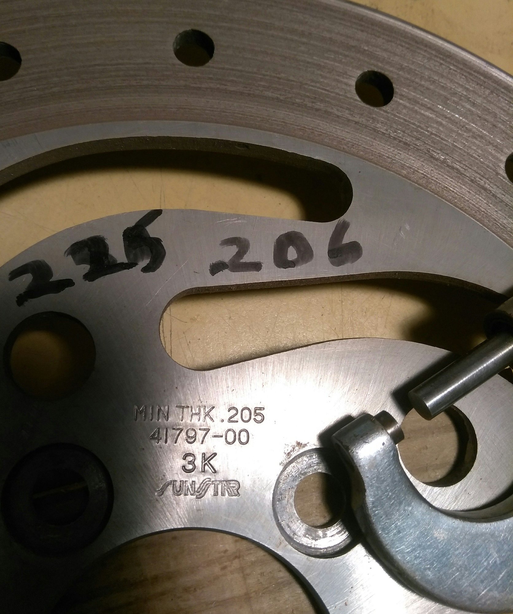

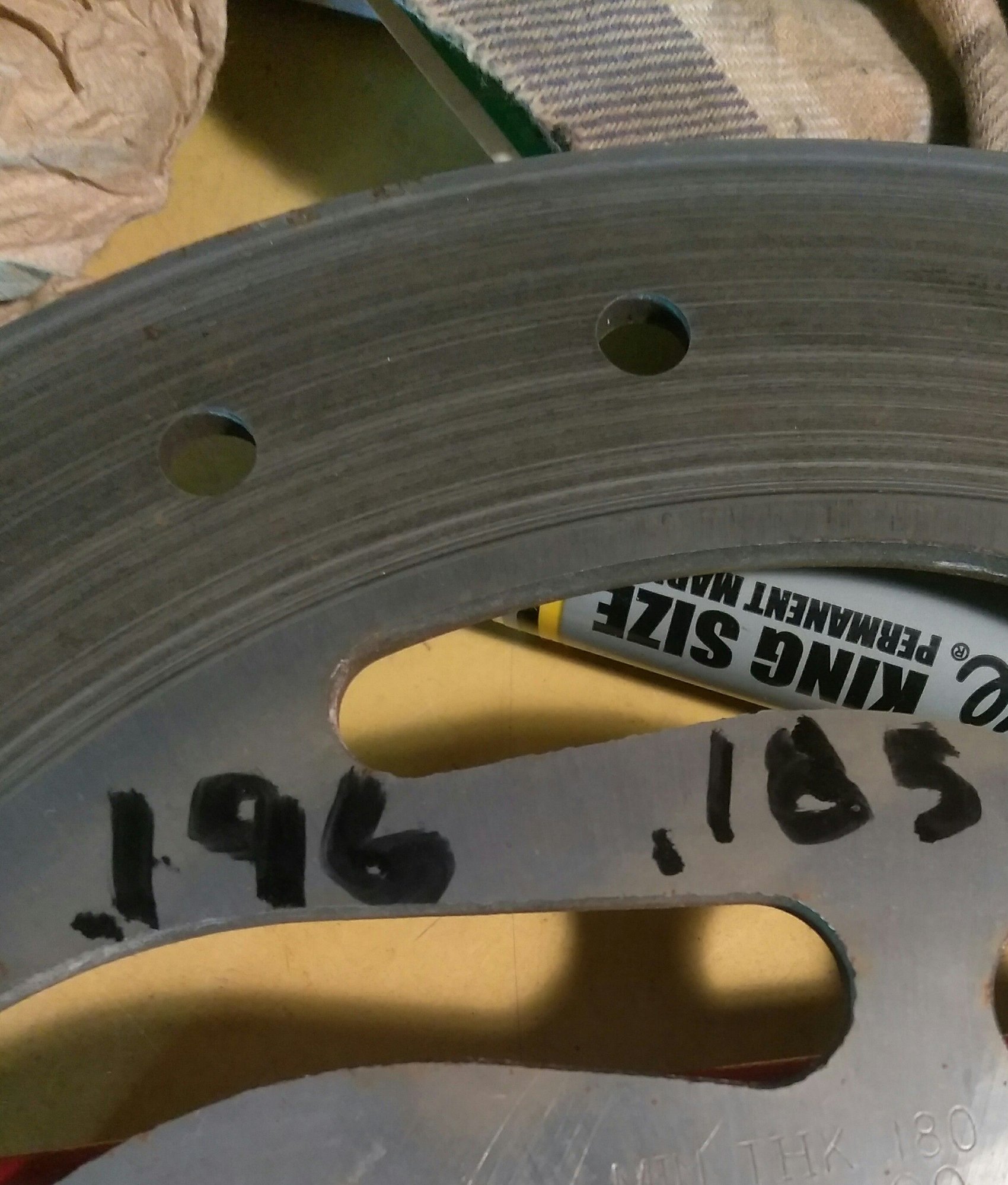

My 2004 at 30,000 was getting it's 4 set of tires. I just usually put a new set of pads on while it's all apart. Mine has the non floating caliper with 4 piston and wear looked pretty even.
Not unusual on a car floating system to see more pad and rotor wear on the piston side.
At 30K, my front and rear were within a few thousands of an inch being at minimum. I replaced them. One was rather rough.
