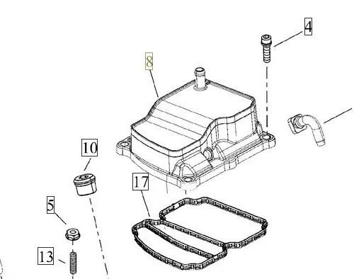

Originally Posted by Old New Rider
Didn't Steve Cole say new M8 VVT's vent thru the crankcase as they should?
The CVO 121 VVT models vent through a new transmission top cover with a built in oil separator. The hose from the top cover routes to the back of the air cleaner.
