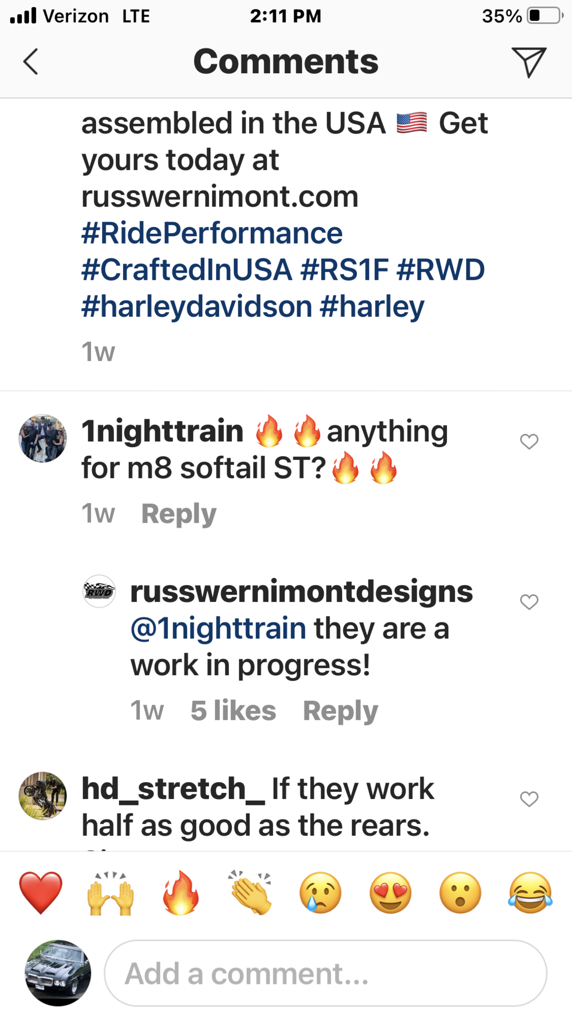

rwd is working on front suspension for m8 softail
